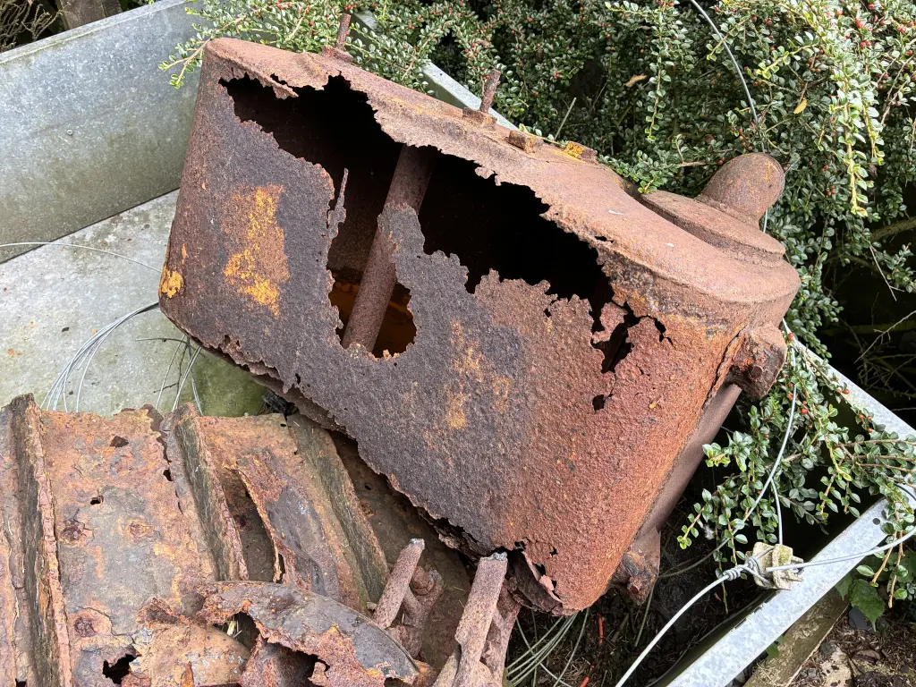

Deas, not sure that one would qualify for for mail/post box out front either

Aw, C'mon, man. Where's that "Avago" atti-tood? Will you at least grant it yard art status?

Hay thanks for the great idea of turning a rusted out tank into a mailbox. This day and age my wife shops from the computer, then hollers when the deliver driver but it on the ground in the rain. But I guess I would be better to start with something better than the pictured tank. But too good of a tank it could go boom when cutting a door. So maybe not so good of an idea ..................................................Oh well.
