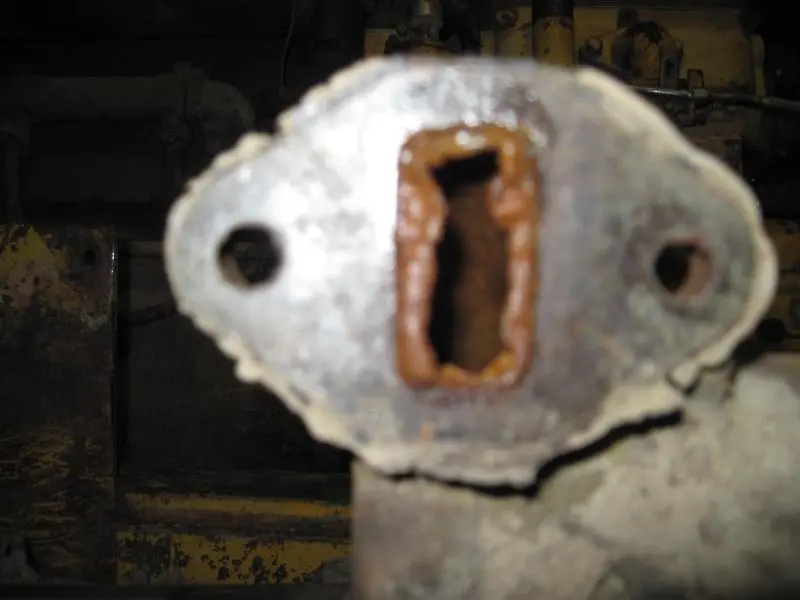

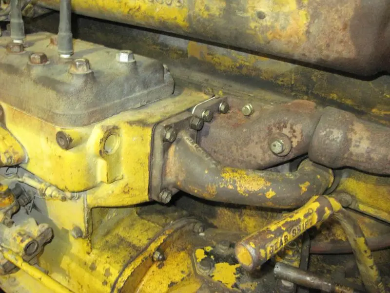

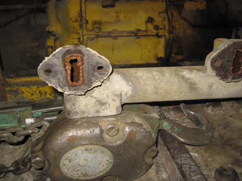

Now I know that most of you on here have made your living around iron and are extremely adept at what you do so don't take this wrong. I am going through my 14a from one end to the other replacing parts with the best pieces I have. As I go I am finding little thing that just weren't put together right. So far I have found brake bands incorrectly adjusted, steering clutch flange bolts not tight/properly torqued, over torqued bolts resulting in broken bolts, wrong bolts(wrong grade and length), using JB weld to fix water manifold crack instead of brazing, trans mounting studs that are flat flange requiring no lock washer with lock washer-the result being not enough threads biting, water manifold not flanged together inline causing one ear to be broke when they tightened it up, pup engine not sitting exactly right, and I'm sure there is more. My point is that there are ways in which true mechanics conduct themselves. Attention to detail and doing a repair correctly means things will last. Here is a picture of the over use of what looks like clear(?) silicone. Every water passage hole coming out of the heads looked like this.:dizzy:[attachment=39363]IMG_1830.jpg[/attachment][attachment=39362]IMG_1829.jpg[/attachment]

Is one of them possibly a gas (propane, cng) mixer?

Looks like the original carburator failed, so a working will fit ???? was adapted to it.

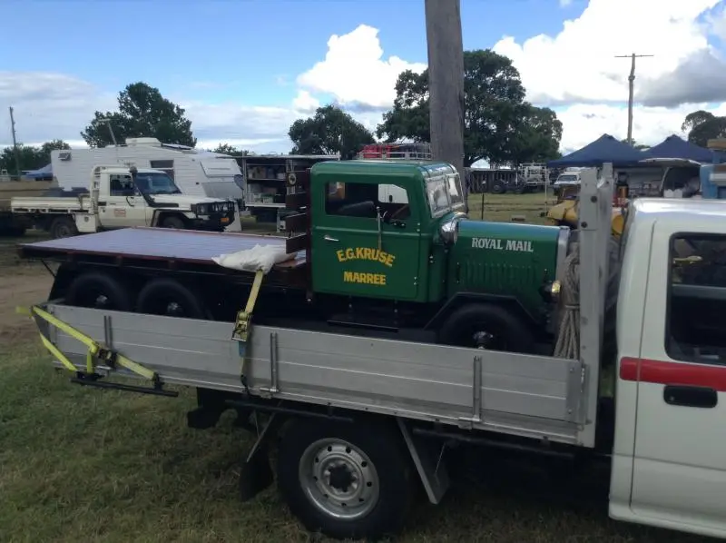

Would this be the little Beaver you blokes are talking about ????
[attachment=39374]IMG_0180.jpg[/attachment]
