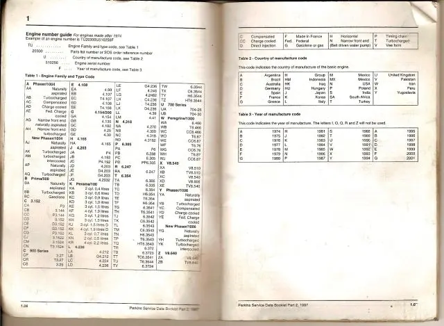

What is the pv 15?
Hi Marcoten, the attached file might help to identify the 3 cylinder you have

thanks waukman, can you post it again as a bigger picture as i have problems reading it, thanks!!

Hi Marcoten, try this one

thank you verry much wuakman!
