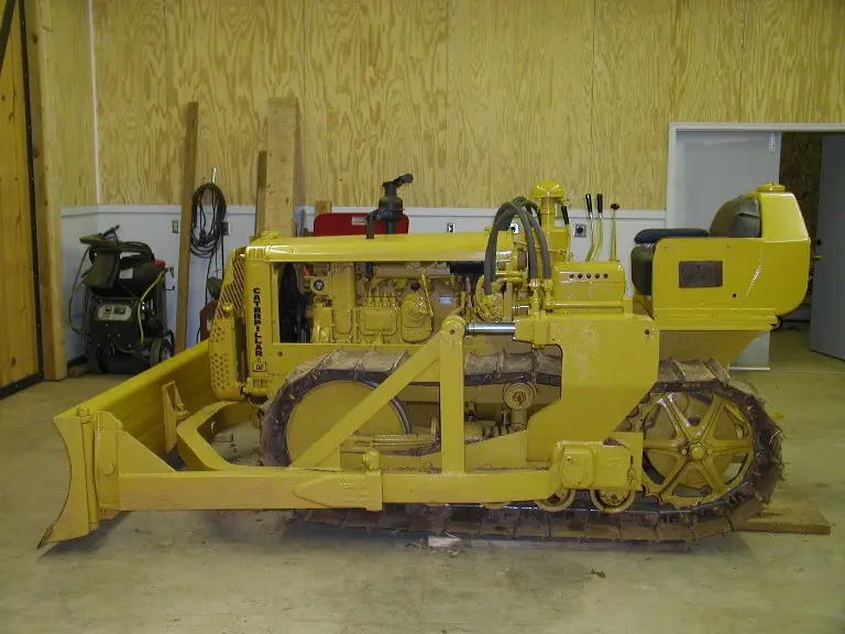

When is the unbreakable, bulletproof, scratch-resistant glass display case arriving for that little jigger?
You've got it looking like that and now you want to get it dirty by hanging a scraper behind it? Or is the glass case big enough for the scraper too?
Seriously - at least for a little while - that is one very neat D2.

Cysco, if I park my D2 12142 in your garage for awhile do you think mine would look like yours? Seriously a fine looking D2:cool2: mine will look like that some day too!

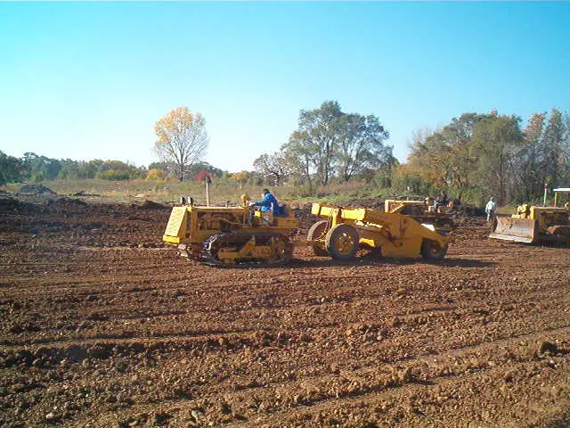

Maybe Chuck C will post a picture of his scraper that he pulls behind his D2. It looks nice and he moves dirt with it also.

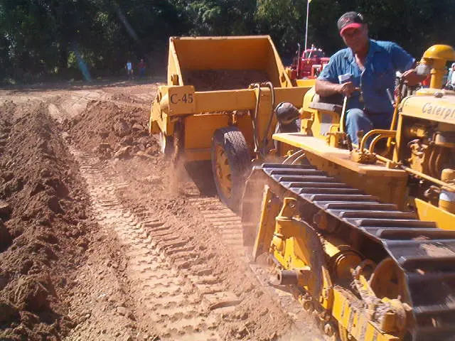

D2 and C-45 LaPlant-Choate scraper

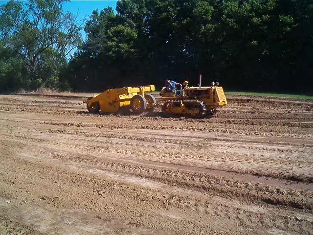

Here is another LaPlant Choate similar to Chuck's. It will still be a while though before my D2 is running and able to pull the scraper.
[img]http://img704.imageshack.us/img704/6802/laplantechoatec24007.jpg[/img]
[img]http://img704.imageshack.us/img704/3163/laplantechoatec24014.jpg[/img]
