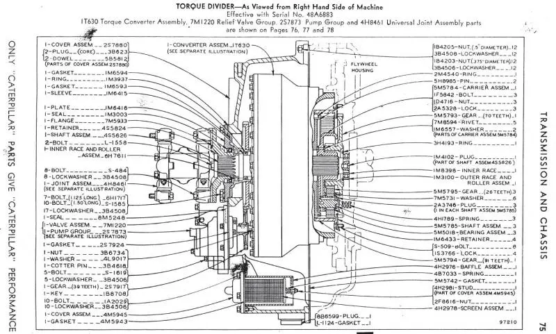

HOWEVER, I'm trying to gather any new seals and gaskets before I get it torn apart and the illustrations and parts books still don't match the instructions in the little grey book. I've noticed that the little book seems to cover D6-9. In one section(Page1 picture) it mentions that the machines equipped with magnetic strainer have had the screen removed from the right front of the bevel gear compartment while the left screen still needs to be cleaned. On the Page2 picture from the book, it shows taking pipes from the front of the transmission(that's not the bevel gear compartment, D6 picture maybe?). ALSO, the parts book shows a screen in the back of the torque divider which the little grey book doesn't even talk about(Page3 picture).
