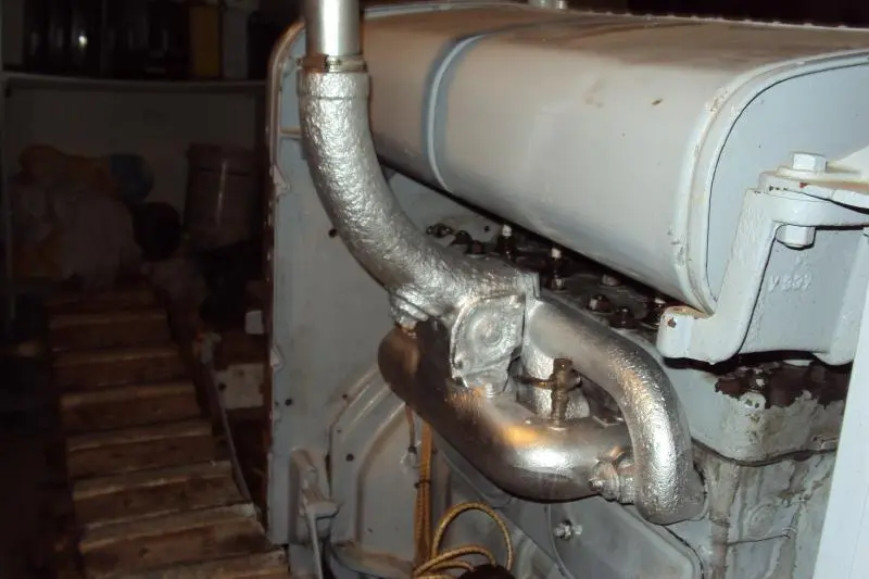

my tips: pre heat with for excample oxy-acyt. tourch, use good welding rods like UTP8 for cast iron , weld short distances, hammer direct the weld after welding for relees of stresses caused by the heat. cool down slow the welded piece.
[attachment=36504]DSC01765.jpg[/attachment][attachment=36505]DSC01777.jpg[/attachment][attachment=36506]DSC01770.jpg[/attachment][attachment=36507]DSC01814.jpg[/attachment]

The pieces you repaired are probably the toughest pieces to repair!
Lots of Carbon Embrittlement!
