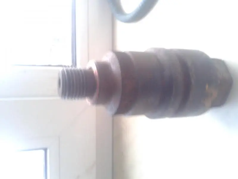

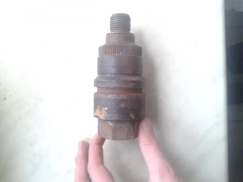

Hi guys,
I am stuck with Precombustion chambers part number for mine machine. I use european catalogue and cant find there engine arrangement 6A5546 for a 3304 engine model 48V1-48V1039
I found 8S3970 for 6A5545 or 5S-6795 which looks not excatly like in the machine now (attached photo). Maybe someone have ideas about the number I need, 5S-6795 vs 8S3970?
Regards,
Maswer

Here is what I find...
951C
s/n 69H2529 to 43508
Engine arr. 2P6779 or 6A5546
Engine s/n 48V1-48V10309
Pre-com chamber 5S6795
Check the wording on the bottom of the 2P6274 cylinder head group where it lists "Part of all engine arrangements" except the numbers listed.
I think that's where your having difficulty with identification.
