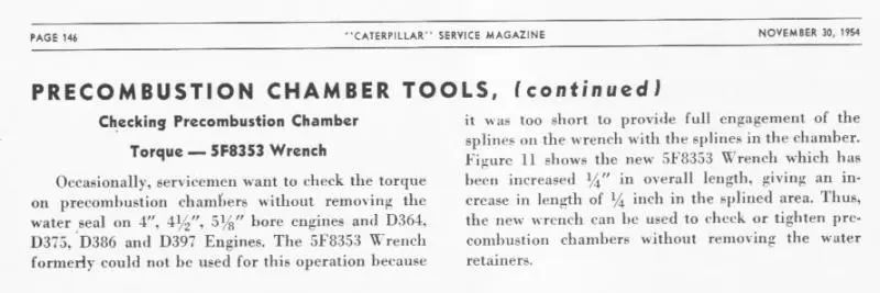

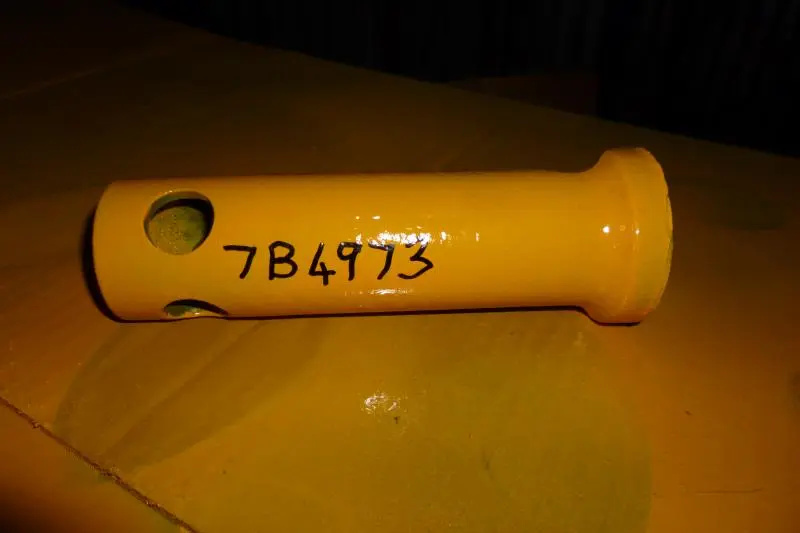

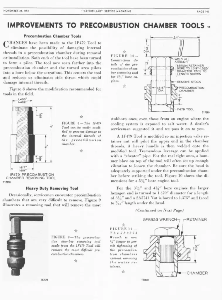

Hi Paul,
scan below should help. It is tool # 1F0479--modified as per Service Magazine, Nov 30 1954.
Tool for injector rem/refit is #7B4973--from the Parts Book.

I think you are referring also to the union nut that holds the injector valve into the head assm?
i can't get the number without digging into my old books in the shop or dig out the special tools, but it's a large, bell-ended deep socket with one side milled away for clearance around the injection tube. They cost a lot. Those nuts get stuck real bad some times. After I broke my wrench and welded it back together, I welded a big nut onto the top so I could use a MANUAL IMPACT WRENCH on it. Since that modification I haven't split it again nor have I been stopped by a rusty injector nut.

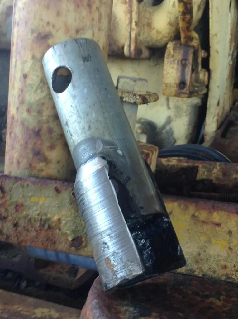

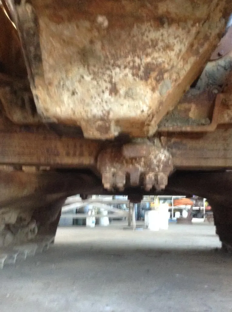

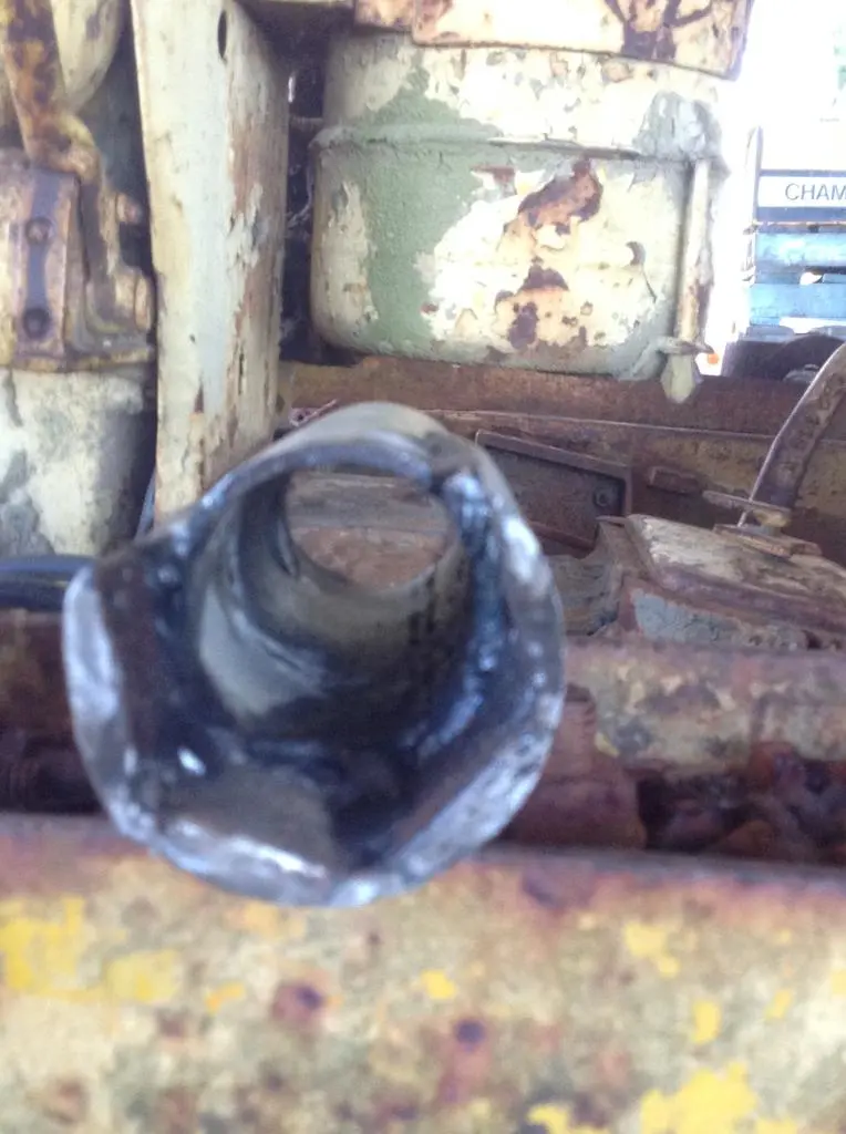

I spent the last day making one up in the shed I reckon I did a real good job I got the two nuts un done on the back head but it just not tough enough for what I need with a tight nut and started to spread anyway hopefully when the proper thing turns up I will be cooking with gas
[attachment=27310]IMG_0197_zpsgrtiqqnd.jpg[/attachment]
[attachment=27312]IMG_0198_zpslosjgxug.jpg[/attachment]

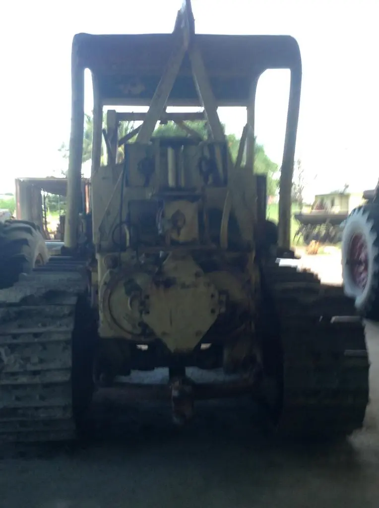

who can tell whats missing free beer from your own fridge the correct answer sorry Swishy stole your line mate
[attachment=27311]IMG_0199_zpsvmqyzixx.jpg[/attachment]
looks she has had a sleep before I owned her

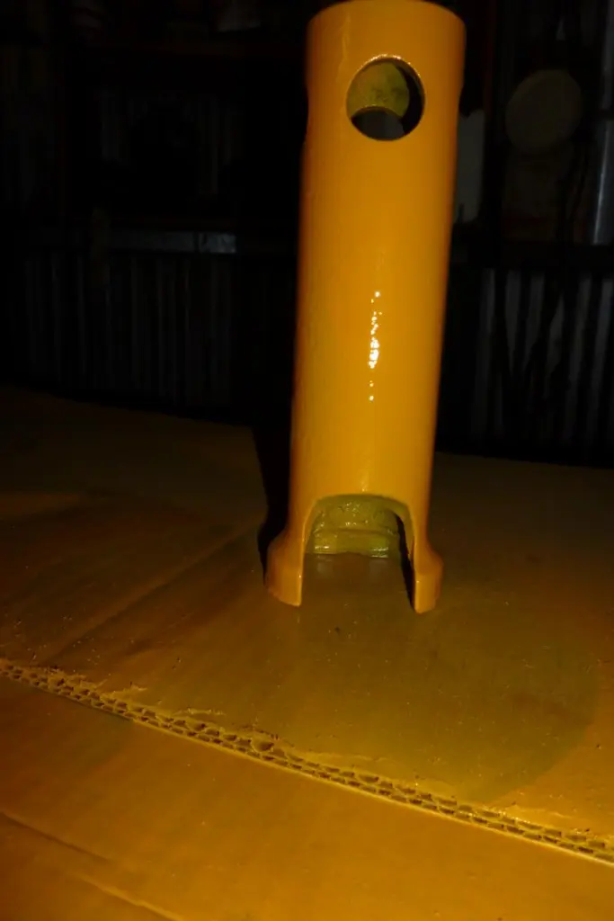

G,day Paul.
Is this what ya want.
A...K...

yes mate thats the one I will wait and see if the one Lance has is the right one and if so I will order one from Florin parts in the US

Hi Paul , That's the one as Andrew's Pic's Showed , mine doesn't have that pretty paint on it , still in its Working Clothes !! Be in mail Tomorrow LJ

Hi Paul,
missing is the auxiliary spring set up.
You run the risk of winding the tractor up and over on itself to cause a severe/fatal outcome.

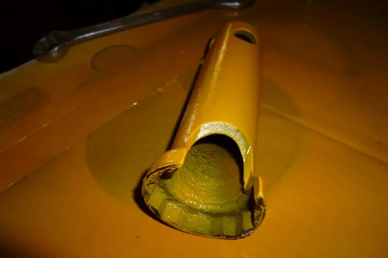

Not a bad production on the socket considering no pattern to work from. The Cat tool is a 12-point and they cut away just enough of the side to allow 1/12th of a turn and then you reset it on the nut. The broached 12point is only about 1/2 inch deep so they could hold maximum strength as far down as possible before they cut out the side. All that, and they still break occasionally.
Give that hand impact wrench some serious consideration. It's amazing what they can break loose. They used to be in the Cat ONE SAFE SOURCE sales flyers. (Anything old enough to have that type injector is old enough to be really rusty...)
