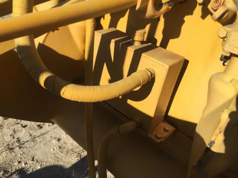

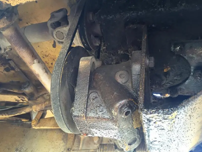

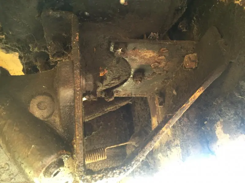

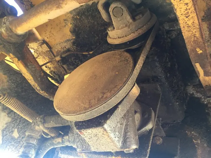

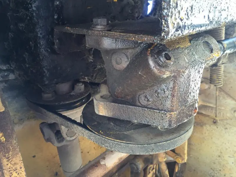

there are a few pics on my other thread on my 12 i going to be out at my grader today. so i will try and get a pic of the pump. i sure there very close from what i can remember off my 212. i would say you will have better luck with hyd then the electric.
http://www.acmoc.org/bb/showthread.php?24819-12-7t-grader-help
Sat, Nov 12, 2016 9:51 PM
mog5858
Posts: 1,324
Reply to mog5858:
hear are some pics of the pump[attachment=38894]IMG_1673.jpg[/attachment][attachment=38893]IMG_1672.jpg[/attachment][attachment=38891]IMG_1668.jpg[/attachment][attachment=38892]IMG_1669.jpg[/attachment][attachment=38895]IMG_1674.jpg[/attachment]
