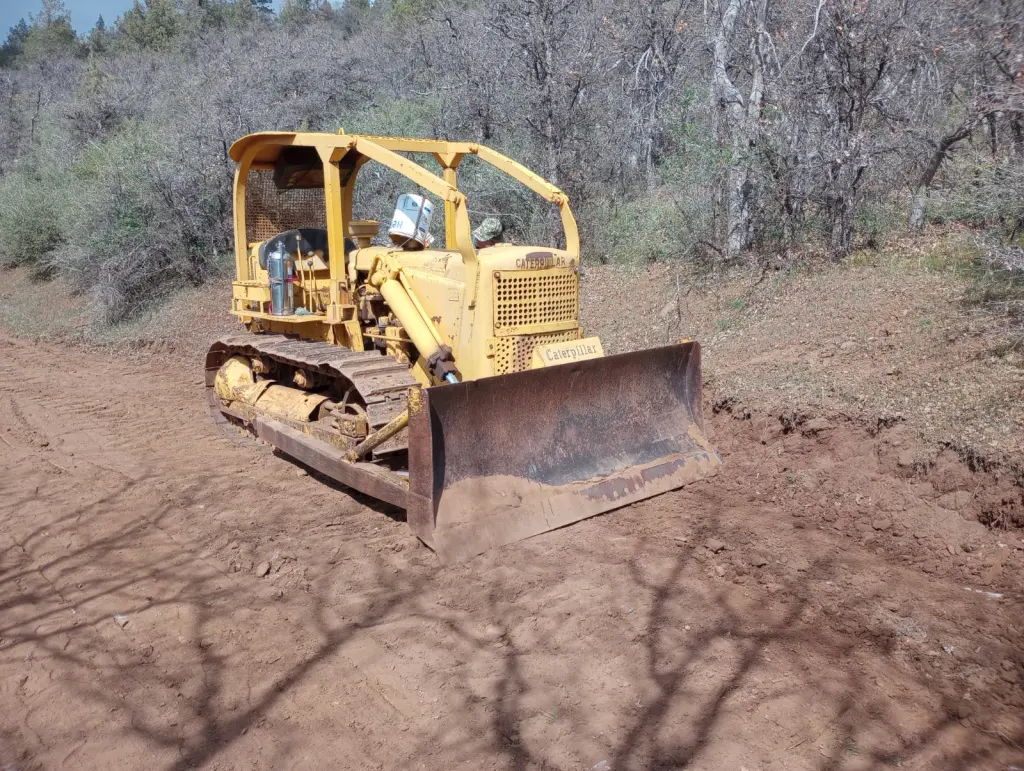

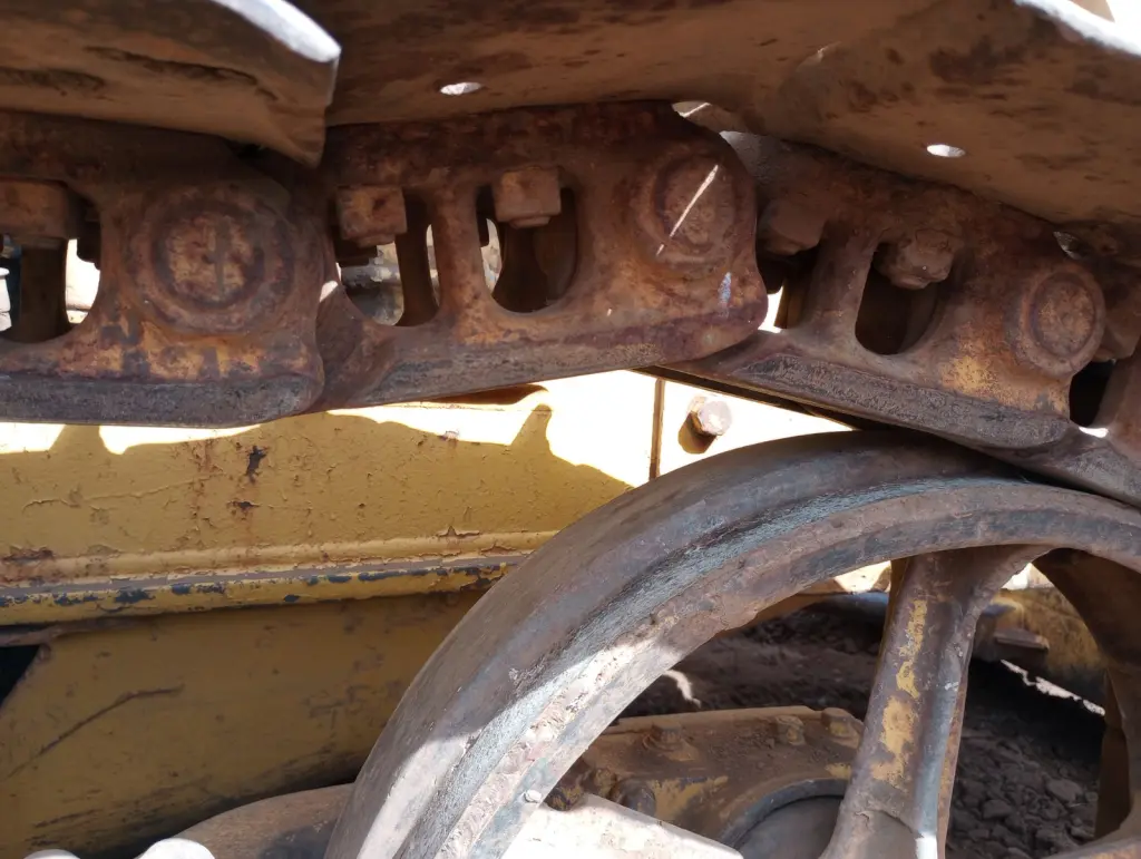

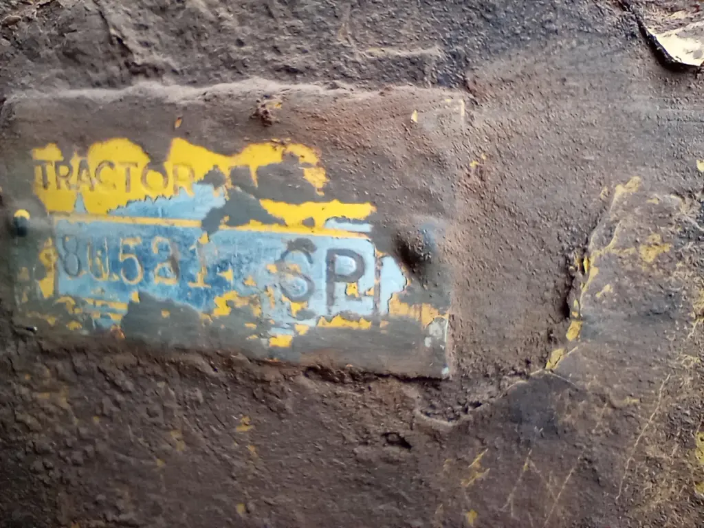

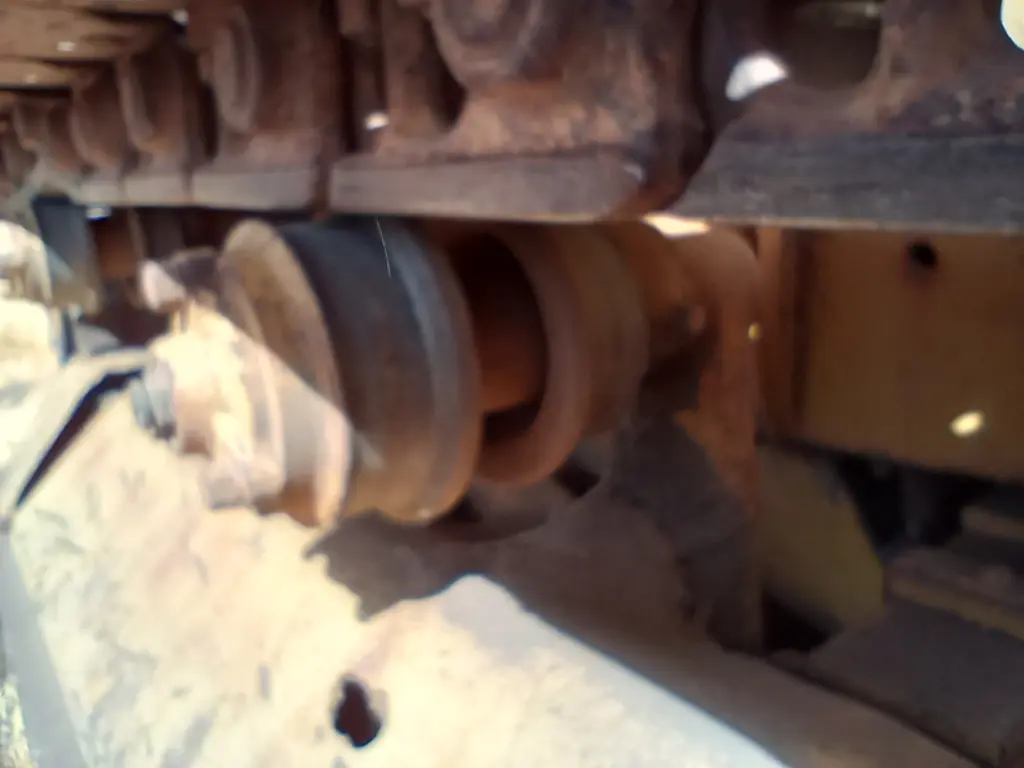

Ok guy's just wanted to Give an update on My D6 I found the Serial # It is (8U521 SP) can anyone tell me the Year? Also I replaced the brushes in the Magneto Cap cleaned the points Adjusted the points replaced the drain cocks polished the rotor and she fired off on the second try. also the main engine fired up on the third try with less than 1 second of spray of ether. Once again Thanks a milllion everyone. Oh can anyone coment on the condition of the tract chain ,rollers ect... [attachment=67465]IMG_20220412_155342704.jpg[/attachment][attachment=67466]IMG_20220412_155403569.jpg[/attachment][attachment=67467]IMG_20220412_155409436_HDR.jpg[/attachment][attachment=67468]IMG_20220412_155325836.jpg[/attachment][attachment=67469]IMG_20220412_155502327.jpg[/attachment]
