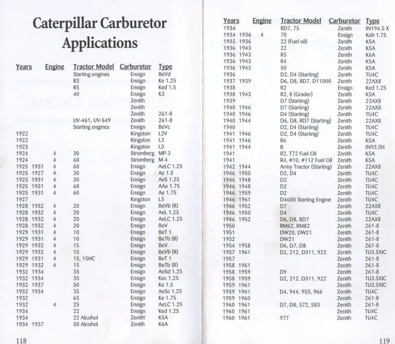

Looking for specs, instructions, carb brand and model of carb for pony motor. Also where to get carb parts/kits and other parts for pony motor. I have no experience with Cat pony motors.

The d7 carburator is ZENITH CARBURATOR and am still have some used carb. and poney parts and you could get a kit from CATERPILLAR

Everyone has given good info regarding the pony motor. It has no model number or parts book etc if its own, but is included in the D7 17a. books.
Just for your information, it is a 3-5/8" bore x 4" stroke 2 cylinder upright engine that produces 25 Hp at 2700 rpm. There were a few changes somewhere along about the 17a's that had the pony and main engine sharing the same oil. Most of those were converted back to separate after it was found to severely decrease life of the pony. Another change that was temporary but could not be changed back was an even fire crankshaft and magneto to match. The original design is basically half of a 4 cylinder so it is an odd fire design which is obvious when you look at the mag cap with two terminals over to one side and blanks opposite them. For a short time, CAT produced an even fire design but soon went back to the original odd fire design. I expect the crankshaft design had something to do with the change back, but that is just a guess.
If it has the cast iron up draft carburetor like the D7e, its not too hard to disassemble and clean. I think I had to make one gasket that goes between top and bowl. On the cast iron carbs, you really need to ream the passages with a drill bit. Of course stay off the jets and needles, but the cast iron rust and old gas can really plug one up. This may require drilling out lead plugs, but I think a lot of the passages are accessible after you disassemble the carb.
The smaller horizontal opposed cylinder pony motors on D2, D4, and D6 use a zenith TU4C downdraft carburetor and requires drilling out lead plugs for most of the passages to properly clean it. I have never heard what model the pony carb on the D7, D8, etc is, maybe it is a CAT design???

Mcdonald carb and ignition is a good source of parts. Can order from them online.
Cat Carburetor Designations....
