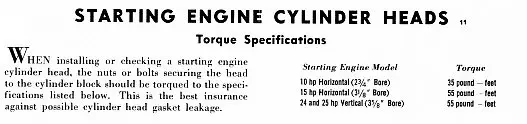

[attachment=60796]Pony Head Torque Specs.jpg[/attachment]
