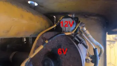

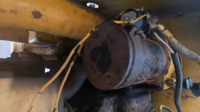

Here one can see on my 8T starter where a previous owner left the 6V starter but the rest of the system had been converted to 12V. They had painstakingly changed the generator to 12V but left the robust starter at 6V. You can see they used a 12V momentary relay. Like Old Magnet said they have been running 6V starters on 12V for awhile now.
