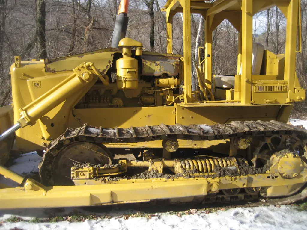

 [attachment=77604]D6 007.JPG[/attachment]I pushed/pulled my dead 9U around the yard with my D3---it moved quite easily as the tracks and brakes were not froze

I have started a D6 by pulling with a 4x4 pickup. It was down hill, but the tractor did not want to roll until it was pulled. My 40 hp 4x4 wheel tractors moves them well on level ground. May have to do some back and forth to make short corners. When I work on steering clutches, I roll them with a high lift jack on the grousers. In the day Cat recommended hydraulic jack. No bending and stooping with the high lift , just need be careful of a slipping jack.
A pony motors just plain likes to be a pain to all that don't want to tinker with them. They all have a personality. Meaning the amount of choke, how many times to turn it before turning gas off to keep from flooding, or many other combinations of things. If your pony has electric starter, you can jump it from a 12 volt. Just don't heat the starter by running it to long.
If it has the style of blade in the posted picture, pushing the control all the way forward is float position. A good place to have it to use jack or come along to lift the blade.
