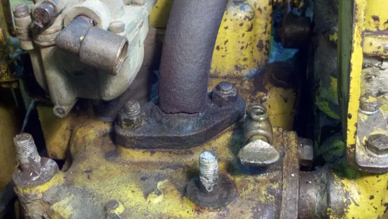

The exhaust manifold on my D2 pony engine is cracked. Can it be repaired or do I need to look for an undamaged used one? I welcome any pointers!

If the metal is good weld it up, If not I sell replacement pipes that will have to be welded in, usually they rot out on the bend a little higher in in your pic

I had an exhaust shop make me a new exhaust pipe for my pilot motor last year after the old one rotted, they used the old mounting flanges, only cost $60 from memory.

Hi Delta, my D4 one was like that, That crack will weld easily enough, it's probably worth welding if the rest of the manifold is in better shape. I did mine with my MIG welder after first cleaning the rust off the area. I guess gas weld or TIG would be better but I don't have those in my workshop!
Regards Julian.
PS, it's probably worth adding that this is not the easiest job on the cards for a MIG welder, someone with a few hours experience would be advantageous.

Yep, weld it slow and let it cool down before you strike again, just spots not a continuos weld.

I'd recommend building a jig to hold the manifold while welding or fabricating or it will never match the manifold flanges again.

I'm using my MIG welder and the smallest wire that I have; .035" and I'm burning through pipe. Very frustrating! Does anyone have a source for a replacement pipe that I can weld to the flanges?

I once looked into ss tubing from McMaster. They had a long radius el that looked usefull but I did not follow through.
