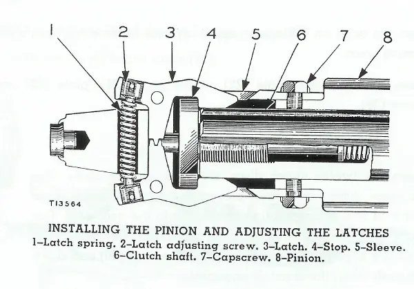

Should look like this.....
Are you ordering the right item? 3B5441 is 2 tooth, 3B5440 is one tooth. Opposite of what you stated.
I'm not aware of double two tooth versions but I suppose anythings possible.
