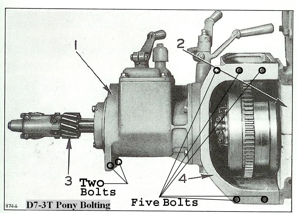

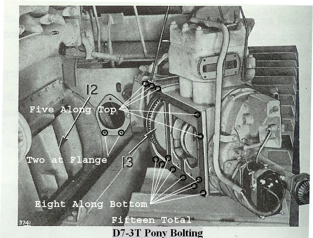

Removing pilot motor and replacing with 24 volt starter. D74T. I have removed 11 x 3/8 bolts including the two under pilot clutch housing. The unit is loose however seems to be binding around diesel motor clutch housing. Have I missed something. There are no bolts in the starter transmission
housing.
Any help much appreciated.

More bolts to be removed.....

Found the two culprits. Glad Im not putting the unit back in. Thankyou so much for your help. Ray

I cannot believe the location of the bolts holding this pony on to the engine and clutch housing. Thanks to Ol Magnet for the info. I have one bolt
to go. I have cut up spanners to get to the bolt. Ran out of daylight tonite. 10 pound sledge hammer might be the go when it comes out. All good fun
though.
