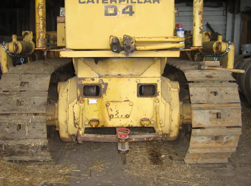

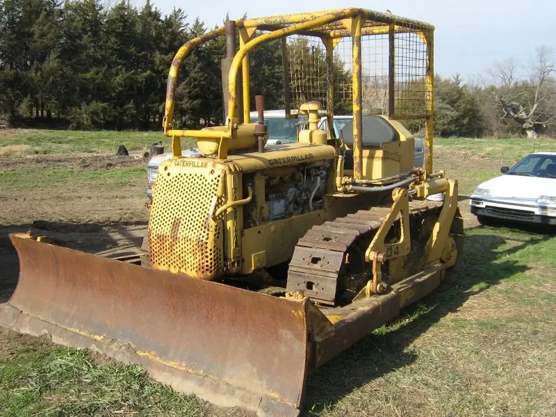

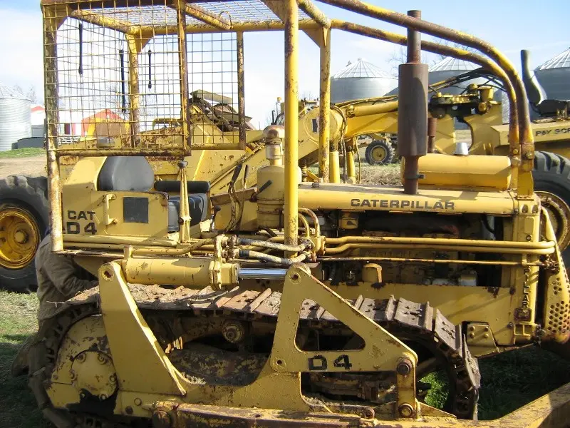

I bought this D-4 at a farm sale in November 2008, first time with pictures attached so hope it all works. There was a D-4,($2500) D-5,($20,000) Cat 112 grader, ($2200) International self loading scraper,($6000) and D-7 at this sale.(didnt sale..(wanted $8000) was 1944 year). I ended up with the D-4.😊 It had some issues, the pony motor didnt run, although it was free and turned over just fine. The left steering clutch was stuck and the undercarriage was still usable, enought left for my use on the farm. I didnt hear the engine run until after I bought it. We pull started it and started right up and sounded real good. The oil level in the crankcase was above the full mark, some concern there, have not been able to determine if was overfilled, or anti-freeze, or diesel fuel cause this. I need to get under there and pull the oil pan plug, but I am a bigger guy and dont fit.(Has a steel shield in place). Need to drive it up on some railroad ties, or over a ditch. I didnt see any rust in the fill tube, or any smell of diesel, but thats doesnt mean I dont have issues. Right now I am at a point where I have the steering clutchs fixed and going to check the main clutch, then tackle the pony motor. If the weather cooperates, (I am doing the work in a pole barn), and sun shines and the wind stays down, I am able work on it most days if the temperature is above 30 degrees. Anyway I have found alot of help on this site, and really appreciate everyone's help...thanks

Think you done good😊 😊
Good luck with her and thanks for the pictures.

What a nice find. You did good with the rear hydraulics and the additional hydraulic tank. That machine was probably used for a #40 scraper or some other heavy use implement. Good luck. keep us posted.
