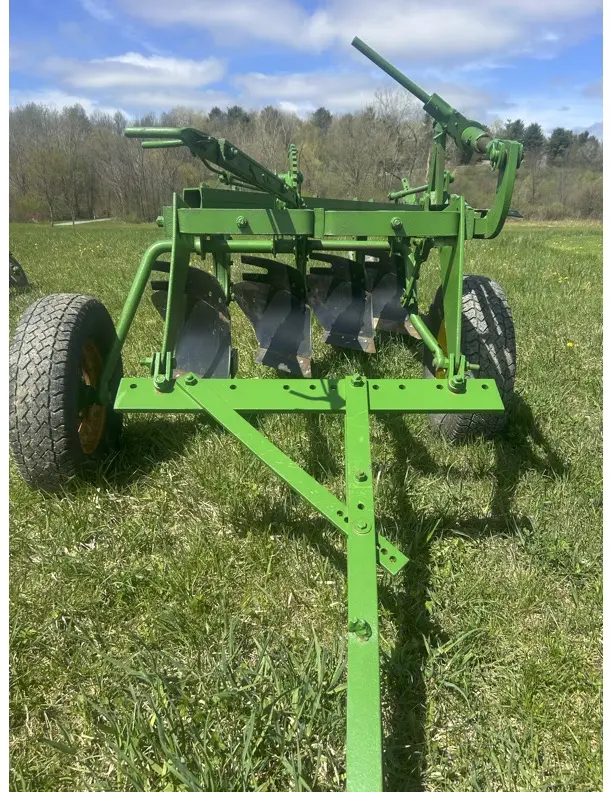

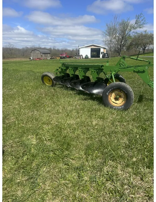

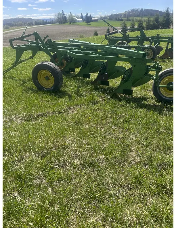

Hi team, there's a JD 4-14 trailing plow for sale locally and he's asking $2000. It doesn't have any coulters but otherwise looks ok in the picture. I'm going to look at it tomorrow night and see how straight it is, wear, etc. He reckons coulters could be had for $50 each but that's vaporware until it actually happens.

It also needs an hydraulic ram, so with the lack of coulters or ram, what do folks think it's worth? I haven't seen it plowing - he uses his 4-16 behind his D2 (we have sandy loam here) - you can see it in the background of the last photo.

Around here hardly anyone uses a plow. Prices all over the board; whatever it is worth to the buyer! That IS a nice looking plow, many plows here have the coulters removed; unless you like the eye appeal, you should be able to flip some dirt without them anyways.

Neil, maybe the seller missed the decimal point in the price. I bought a JD 3 bottom roll-over three point plow for the small 4020 to dress up some terraces and paid $75 for it and with good coulters. Location means a lot in price but in the Midwest I would expect to pay about $100 for the plow pictured
If you have much trash on the field, coulters are a must but with little trash they are not necessary but they do make a nicer looking cut.

That is an early 1960s vintage John Deere plow. It looks like maybe a F620 model. I have had a couple of them over the years. They are one of the better trailer plows out there. I prefer the heavy duty F690 model with my D4. The price tag is about double what a really nice one with coulters and cylinder sells for around my area (Central IL). One thing we found is that Deere and other manufacturers used an extended hitch with plows used on crawlers. We have copied these and put them on a couple plows. It makes a huge difference in making the draft angles correct and makes the tractor much easier to drive.
