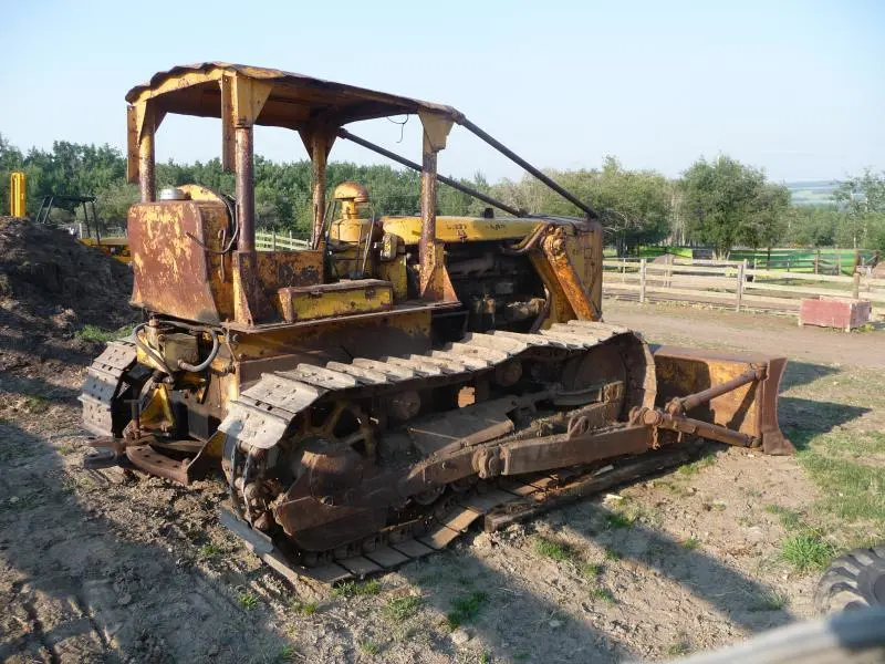

here's two pics of my 5r sn 5r189 through extensive hours of research, i have not found any 5r's that are known to be around that have a smaller serial number. i bought it from the original owner who purchased it brand new from union tractor in Lethbridge Alberta in 1942 [attachment=34224]Hauling cats Oct 2010 008.jpg[/attachment][attachment=34225]Hauling cats Oct 2010 007.jpg[/attachment]
and a pic before and after of one 9u that i fixed up and sold. serial number of the tub and tracks was 9u4620sp and the engine came out of 9u6222
[attachment=34226]aug 2 2014 057.jpg[/attachment][attachment=34227]June 8 2015 019.jpg[/attachment][attachment=34228]June 8 2015 018.jpg[/attachment][attachment=34229]June 8 2015 017.jpg[/attachment][attachment=34230]June 8 2015 016.jpg[/attachment][attachment=34231]June 8 2015 015.jpg[/attachment][attachment=34232]June 8 2015 014.jpg[/attachment]
4620sp had a front ccu 6a cable blade and hardnose, when i swapped the engine over i installed the hydraulic hardnose , c-frame, fuel tank and fenders from 6222, and the canopy from 9u26206
