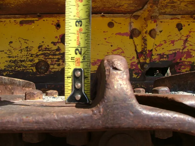

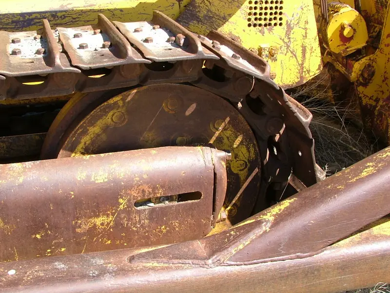

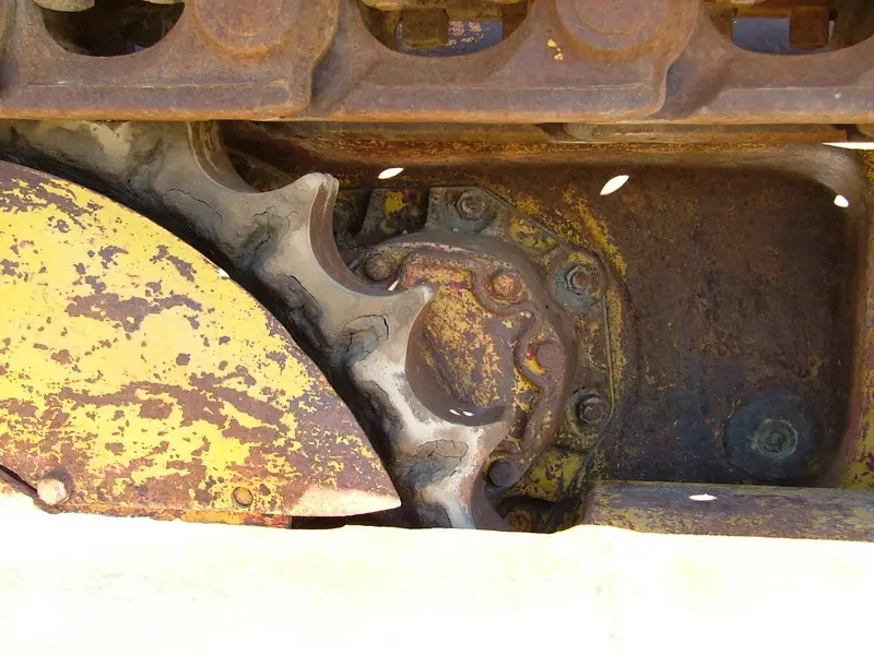

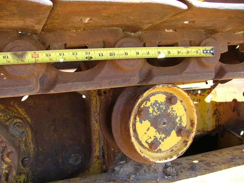

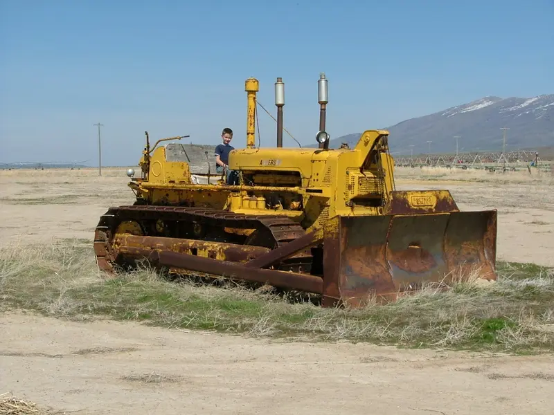

I got around to taking pictures of an old TD24 that has been sitting for many years. I don't know who owns it or anything else about it. I just have the pictures I have taken. What do you think of the undercarriage in particular?

Nice looking old dozer, if no one can help you here, go over to the Redpower forum and post it there as well. The forum for IH nuts!

Nothing covering the exhaust. Probably stuck engine. UC looks good. My wifes grandpa had a TD20C was a good machine for him. Had some minor hydraulic leaks but normal for it's age. I wish I could have talked grandma into keeping it.

That machine does appear to be in not bad condition. The uncovered exhausts could be a bit of worry. Another concern is the grouser height relative to life left in the rest of the tracks. I suspect that this old lady may have seen some hard rock somewhere, sometime.
The TD24's were hardly one of IH's brightest stars. They had plenty of grunt and could put it on the ground but they were not in any way like Berger paint - 'Keeps on keeping on'. They had weak finals in the early ones which I don't think they ever cured. One series had a master clutch that had about 4 'U-beaut' sintered bronze buttons on each side of the friction plate that were never supposed to wear out. That part was fine. What wasn't so flash was that the flywheel and pressure plate used to wear out instead, where the buttons rubbed on them.
The TD24 was introduced in 1947. I started operating full-time for a crust in 1965, just 18 years later and I have yet to operate a TD24. They disappeared from the contracting scene THAT quick. There are still quite a few 2U D8's from the same era doing a bit, even today. What does that tell you?
If you want it as a curiosity, to take to shows for its unusuallity, or maybe as a paperweight. 'gopher' it. I'd like to operate one before I depart this mortal coil but I think you'd need a head full of RED rocks, all labelled 'IH', to LOVE one.
Just my 0.02. Hope it helps.
