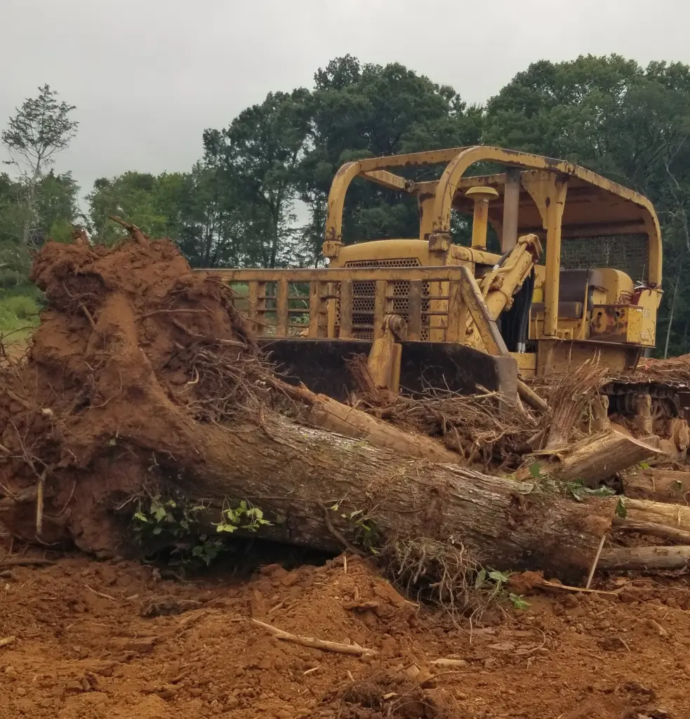

Always wear the seat belt! One gets jerked around pretty hard running over stumps and debris. I am going to try to post a recent picture of my tractor.
1963 low horse D7E (47A) direct drive.
converted by previous owner to 24VDC electric start (positive ground )
Picture is with root rake. blade with guard on top is a little over 6 feet tall.
undercarriage is a bit tired.
