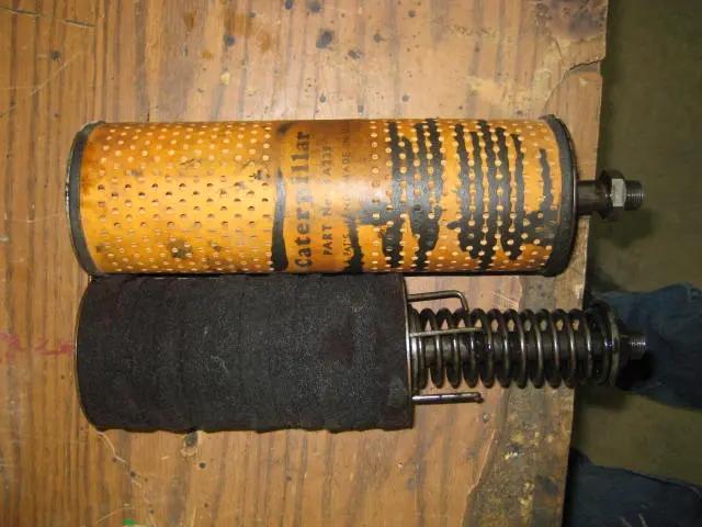

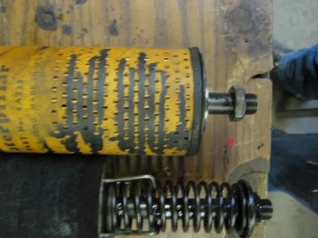

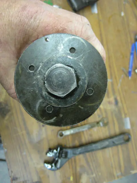

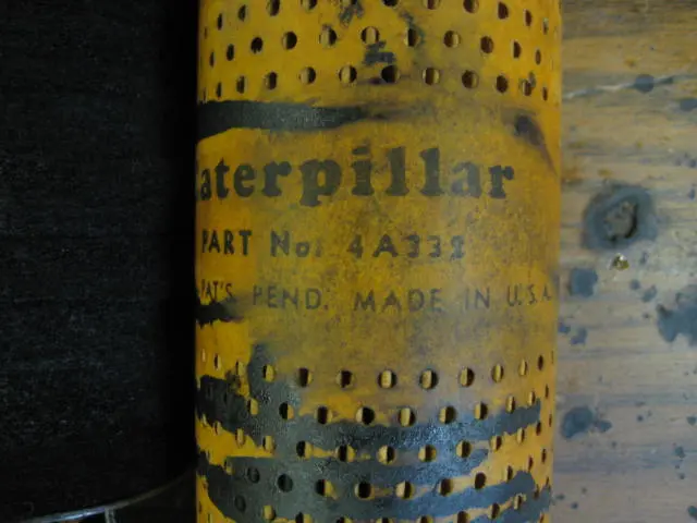

I found some picture that I had saved on my computer. I hope that this will help. The filter that I used is a Caterpillar 4A332. This number has also been discontinued but it changes up to a new number that I can not remember. The 4A332 filter is just about the same OD as the felt washers but it is longer than the stack of felt washers so you will either need to find a new spring or cut the old spring off so that it will hold the steel washers tight against the new filter. As Throw the four steel pins away that hold the felt and steel washers together. I hope the pictures help.
Ken

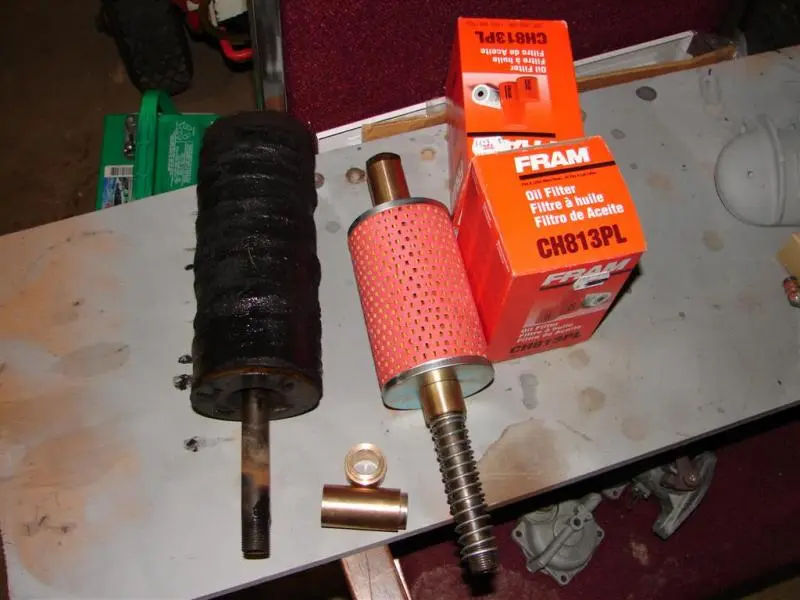

Thanks for posting the pic, note the spring and ball for the bypass, It looks to me like the oil is pumped in through the center tube to the top and flowes through the filters into the 2 ---3/8 riser pipes that hold the filters.
I did a retro fit my self using off the shelf filters and some home made adapters, note these filters are listed to be used in Cat fork lifts lifts as well as many other apps.
