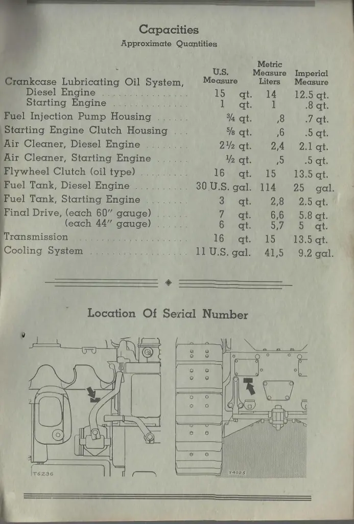

Operators Manual for D4 tractor 6U1 up, 7U1 up.
[attachment=50765]operators manual form 12244 7.jpg[/attachment]
[attachment=50766]capacities d4.jpg[/attachment]
Form 10766-3 - Operators Manual for D 315 engine has the same information for the starting engine.

Reply to willwingo:
"If you forget to put the drain plug back in its two quarts"
