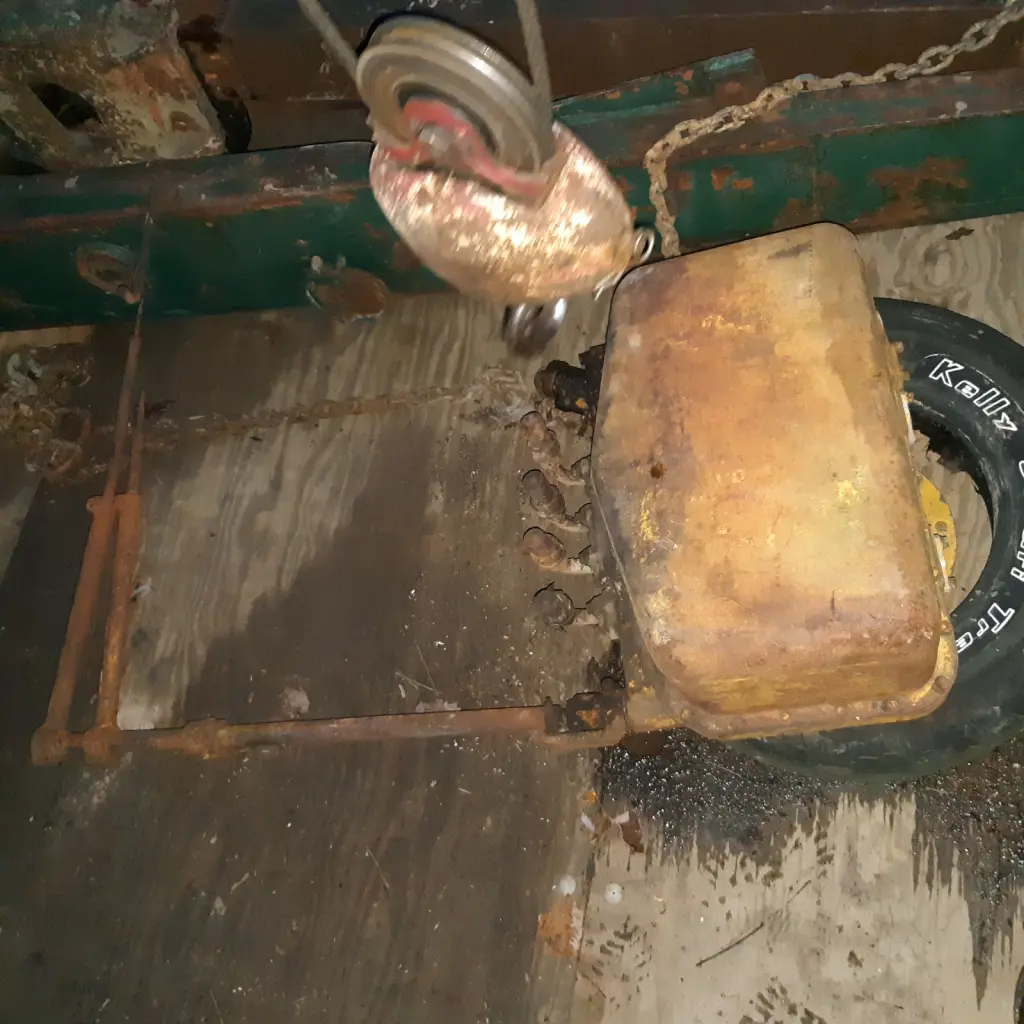

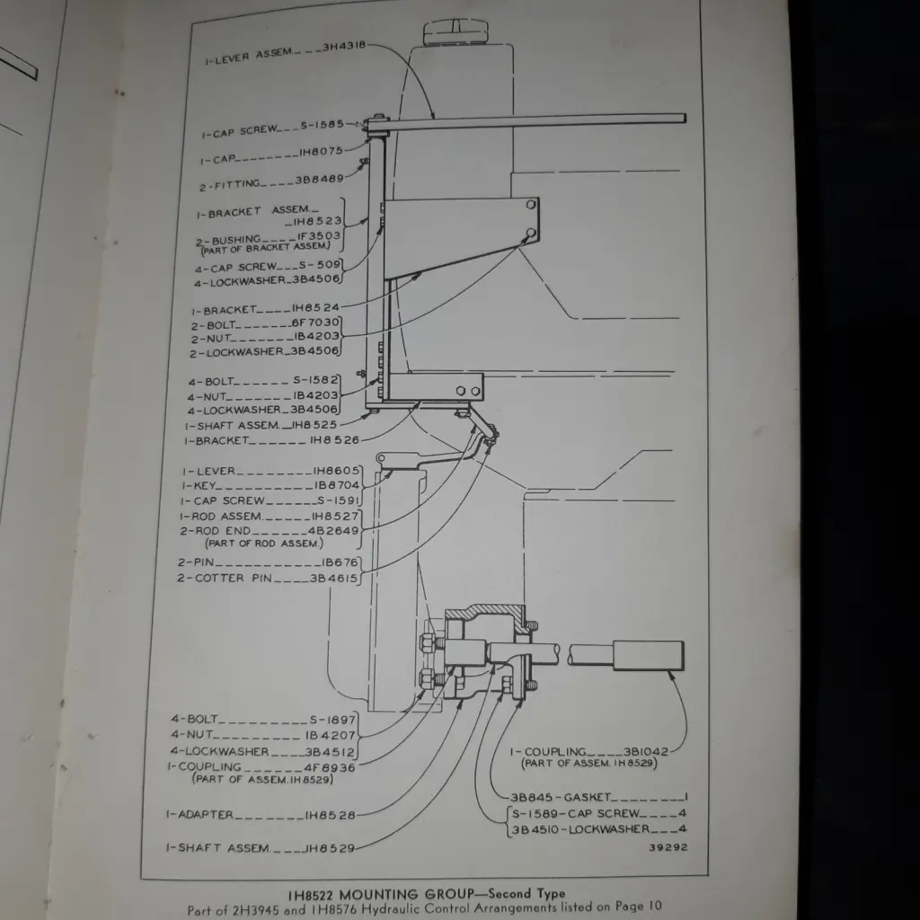

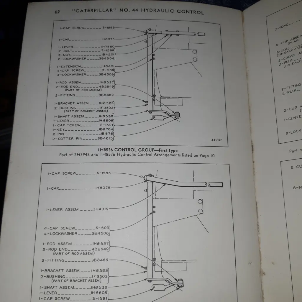

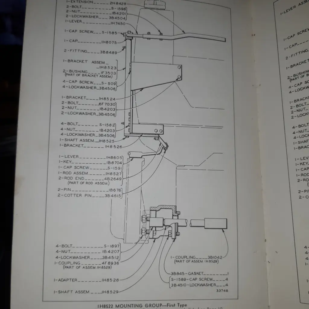

Does anyone else on here have a rear mounted No.44 rear mounted hydraulic pump on any of their stuff? I acquired one awhile back. This one is off a D6 or D7 but I want to mount it to a D4. I've never actually seen one mounted to the rear of a machine. I see in the parts book the mounting arrangements.  [attachment=69984]20221207_164638.jpg[/attachment][attachment=69985]20221126_171718.jpg[/attachment][attachment=69986]20221215_191343.jpg[/attachment][attachment=69987]20221215_191348.jpg[/attachment]

Oh I figured I'll have to make all the stuff to do it. Figured maybe someone else had one somewhere for photo reference but if not I'll just make the parts look as close to the parts book as possible. I'm setting it up to pull a pan not run a dozer.
