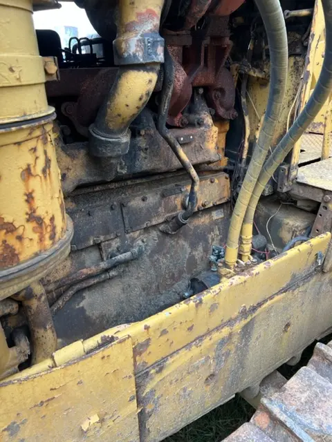

Many thanks for the welcome and all the information......feels like home already! I have books on the way and looking forward to learning all about her. I can't get the winch to work. The lever with the button moves like it's not attached to anything and the other lever won't move more that about a 1/4 inch either way. Here are a few photos of what she looks like now.![]()
Most likely the control cable is binding, might need replaced. Another note, when you change engine oil, there is a drain plug under the transmission/steering clutch pump under on the right-hand side, holds about a gallon. Then clean the magnetic filters on the front left and right rear of the engine. Then grease the fan pulleys. All at 250 service hours. This manual is a must have, caterpillar d7e operation and maintenance manual | eBay
