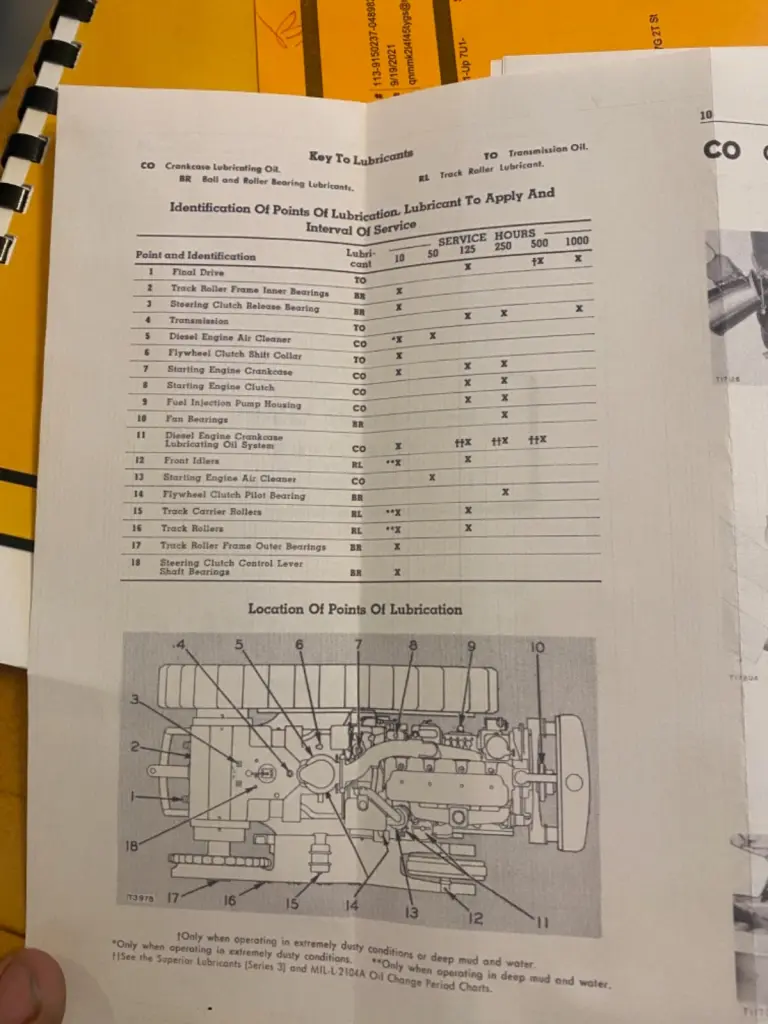

 [attachment=64743]75BA2C3A-0618-432D-BC75-75B5E87202D0.jpeg[/attachment]
Needing some “real world” advice on oils for my D4 7U with HT4 loader. I found most information in the Operator manual but some of the information is obviously out dated and better oils/grease is now available.
Anyone have a list handy for compatible oils?
Any help is greatly appreciated, thanks.

you can use 15w40 diesel engine oil or 30w diesel engine oil in the crank case. you can use 90weight or 85/90 in the transmission. you can use 90 weight or heavier 85/140 gear oil in the final drives. if your rollers are the old style with the button zerk and the seals are good you can use 000 grease or if the seals are leaking i use corn head grease. if your rollers are the newer style you can use 30w engine oil to top them off. the hydraulic can use 10w engine oil or a little heavier or hydraulic oil.  for the pony just use 30 weight engine oil and change it often. the old oil spec was non detergent so the sediment will come out over time.  the gasoline has a tendency to dilute the pony oil also.  son't forget to fill and replace the oil in the injection pump sump often also. i use 30 weight for that
