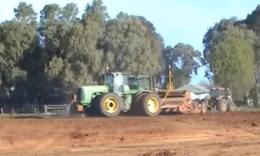

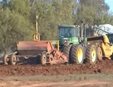

The Bagsshaw scoops you see in the second video are by far the most common scoops in Australia they are extremely fast as in almost but not quite road gear when leveling and have a almost zero rock from side to side at speed which greatly reduces the amount of constant clean up than can be required with high speed leveling
Those Bagshaw scoops were designed by a farmer and sold under the Allfarm name until Bagshaw bought the company they have 3 or 4 well spaced wheels on each side on a rocker setup they are nice and low so you get see exactly whats going if you can thru the dust and they are very strong as well
The only down sides are the bowl is deep so depending on what your trying to load they can be a challenge at times to fully fill the back of the bowl and the other problem is they dont eject the dirt but that is never really a major problem as you just wait a day or so and then go when the dirt is drier or at least thats what I have with those Bagshaws
[attachment=39837]Bagshaw 1.JPG[/attachment][attachment=39838]Bagshaw 2.JPG[/attachment]
http://www.horwoodbagshaw.com.au/grader.html
Paul

Hi, JanM.
Yes, I have seen that design before in other videos but never up close and personal. I would think it would better for both flotation and compaction with both wheels on each side having an equal share of the weight all the time. That JD seemed to load that scraper pretty quick too - wonder what yardage it was getting?
There is a line in Wind In The Willows, "Nothing is half so much fun as simply messing about in boats." I seriously doubt that author had ever had 'Cat Yellow Fever' or ever messed about with a 'Cat-n-can'.
I still don't think they can match a good spread of open-bowlers and push cats in bulk earth moving and CERTAINLY not in anything remotely rocky. Good loading, yeah, maybe, and on shorter hauls, but let the going get a little tough and - - - - - the TOUGH get going. I'd like to see them getting down the haul road at 45 MPH with 54 cu. yds of shot and/or ripped rock in the bowl after loading in around 25 - 30 seconds - - - or less - - like a Cat 660 or 666.
