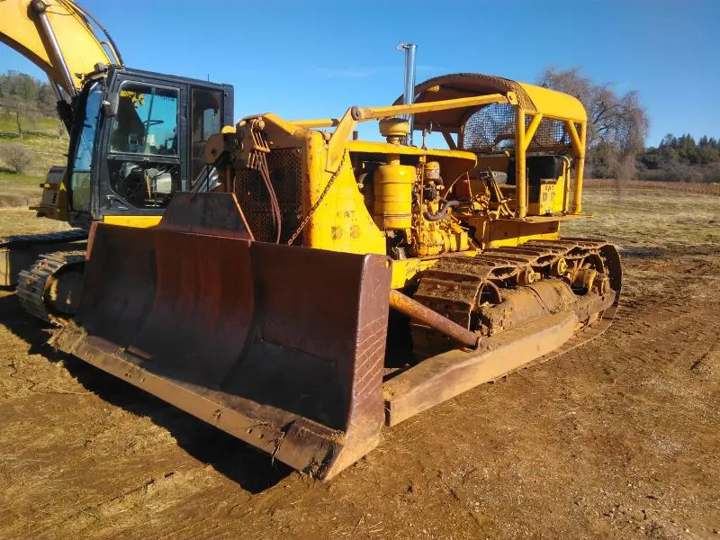

Here are some more pictures

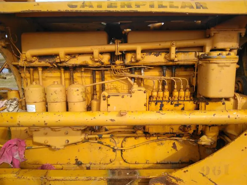

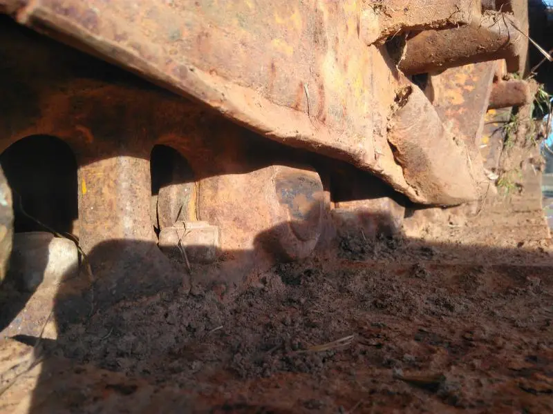

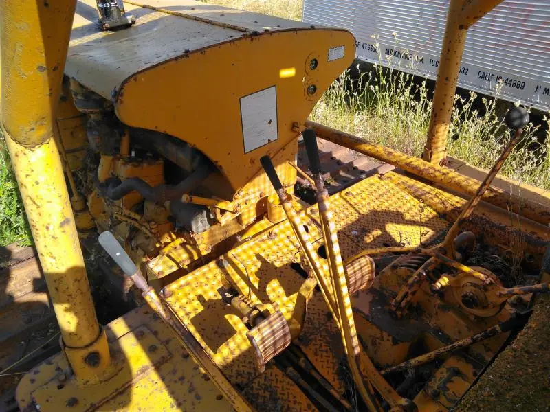

Wear on the Pin Bosses in photo4 suggests the Rollers are shot!
If its a few hours a year machine, no big deal!
If you are planning to use it, then either replacement or reconditioning is in order.

Finally got it home yesterday. Im still waiting on my manual to show up. I couldn't figure out how to adjust the clutch. So it was slipping pirty good going up hill. But i got it into position where i want it. The wear on the pin bosses i believe is from the lower sheild here. Forgive my terminology im sure theres a proper name for it. But its definitely mangled enough to be making contact with the links.
