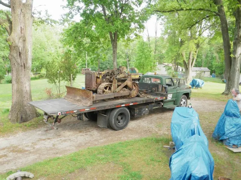

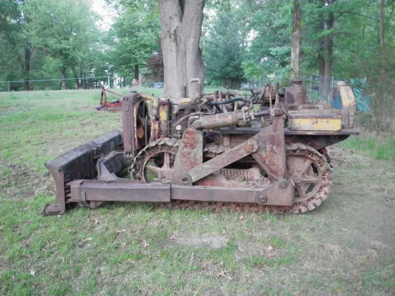

Well, after a few delays I got the D2 running, loaded and delivered to my house.
The carb needed rebuilding as it was caked with crap, and I substituted a plastic 1/2 gal fuel tank for the pony motor fuel tank because that was so rusty it had developed a large pit that was leaking. I also replaced the points, plugs and wires. The pony motor now starts fairly easily for a rope starter. The diesel fuel system needed bleeding, but after that it fired and ran nicely. The right steering clutch was stuck for a few minutes, but after some working back and forth it is back in order. The tractor had been setting for 8 years. A bit longer than I had initially believed. Anyhow, everything pretty much works. But of course I now have some more questions...
My steering clutch oil cups are missing.. in their place are zerk fittings with crusty grease on them. My owners manual specifies crankcase oil for these not grease. Any advice on how I should proceed?
I need a grease pump with button head coupling for the undercarriage components. Any suggestions on brand/type? pressure rating? etc.
I have many more questions, but I'll save them for later.

Joe, welcome to the club, there's so much knowledge and info here on the site its amazing. I too have a D2 5U12142 and all the folks from all over the world at AMOCO have bent over backwards to offer info, kind words and moral support. I 've found CATS are like tattoos you can't just get one! Attached find pictures of my D2

Later tractors had grease lines installed instead of oil cups and some were retrofitted as well. Use regular chasis grease in these fittings
Alemite makes the couplers. I don't have a model number, but an industrial supply can get you one. Some had a relief valve in the coupler so it would squirt grease out when you exceed the set pressure. I have never seen one like that, just a plain coupler that screws on a 1/8" NPT male fitting. You can use a hand grease gun in a pinch. The tubes of 000 weight grease are available as "corn head grease" from agricultural equipment dealers or your local lubricants dealer. If you want to do better and can find a used bucket pump, don't be cheap, buy it, a new one from Alemite is very costly.

D24U,I have seen where some folks have changed their oil lines to grease.I had thought of doing that when I did the steering clutches on mine.After buying parts and tubing and all that,I determined that it was best to leave it as an oiler system because it just didn't look like the grease would get to the bearing where it belonged.I did pack the bearing with grease when I installed it.
I am not trying to give you a fright about it but I would try to clean the grease out and see if you can pump oil down the lines.
There is no way of telling exactly what is in there without pulling the final drive.Don't do that untill you have to.
