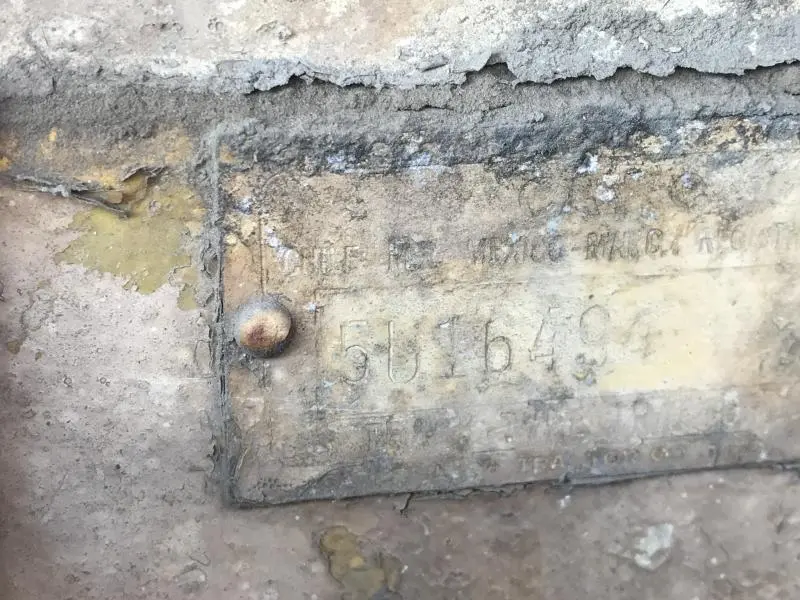

Post your Serial Number so that anyone referencing their Library will get the right series as there were several iterations of part numbers.

Serial number is 5U16494

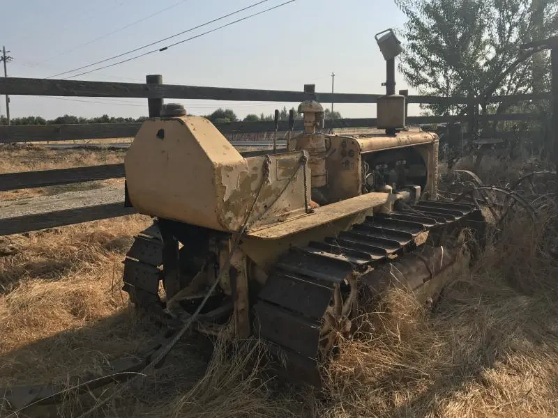

Welcome to the bulletin board. That’s a snazzy little D2. I like it! Looks like DE start to me, so good batteries and a healthy priming of the pump might be in order.
We like photos. Next ones should be of it churning up some dirt!
