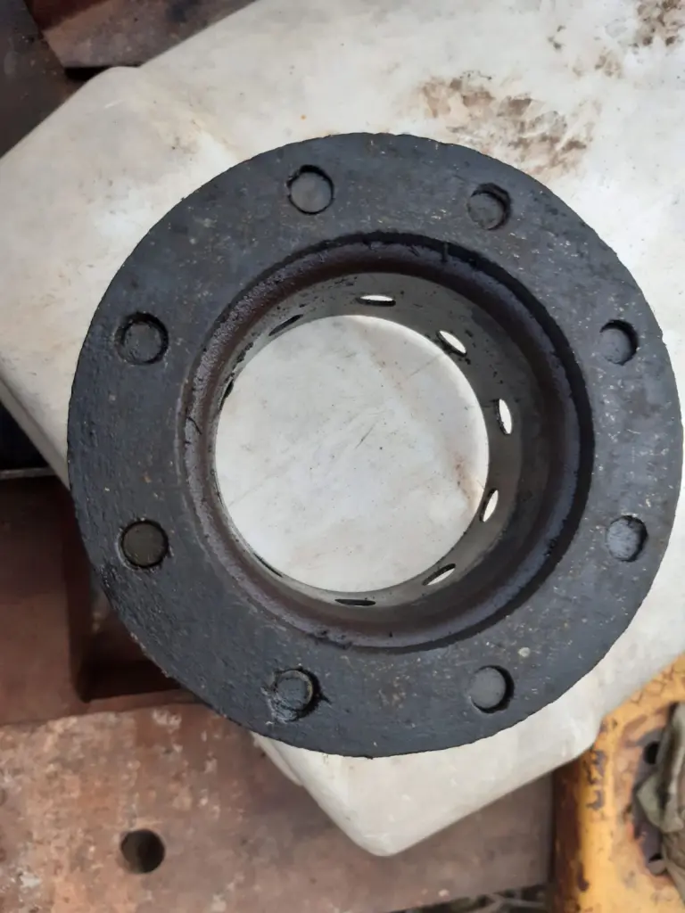

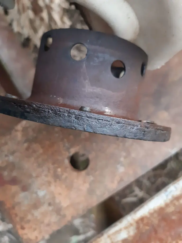

Welcome SlowHand, it sounds to me like the clutch brake is not working, the lining might be worn away or broken, or covered in oil if you are lucky, because you mention you can put the 22 in gear with the engine stopped, and then pull the Cat with another tractor with the clutch pedal depressed and the engine does not turn, that tells me your main clutch is releasing as it should.
All these old Cats have a small circular brake pad on the gearbox input shaft that stop the shaft turning when you go to put the tractor in gear, if that clutch brake is faulty you get the exact symptoms you describe. You might need to remove the gas tank so you can get access to the clutch brake through the top inspection cover, you can then see it easily.
They are adjustable to take up brake lining wear, look at my pics, it is a Cat 22 clutch brake, and you will see the staggered bolt holes in the brake collar that allow you to rotate the collar moving it closer to the main clutch, people have also converted them to a 2 piece brake lining for easier replacement if the original brake lining is worn out completely or broken.

Mike Meyer
Thank you for your response and associated pictures.  We'll have to look to the maintenance book to see if we can figure out the adjustment you describe. Your description and images of the clutch brake make me sure that the lever bar I was seeing pressing against the drum (that I thought was the clutch brake) is not actually the clutch brake.  Live and learn, I suppose.  We'll get our borescope back in there and have a better idea what to look for.  Maybe I'll even get some borescope screen captures up on the forum for you all.  I hope removing the gas tank gives us better access to adjust the clutch brake as you suggest, what I'm assuming is the clutch inspection cover seems like a very small window to work from.  Sounds like I should be grateful that the scenario I've described means that the main clutch is releasing as it should.
