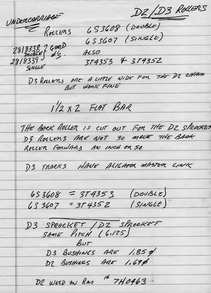

Found my notes on the D2 to D3 roller conversion.....

Thanks for that information. I can see that if I go to D3 chains one day (early), then I would need to get the early D3 weld-on rim fitted to the D2 hubs.
