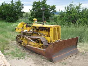

I'm new to this website but have researched much info on the CAT D2 prior to buying one. It is a D2 4U model w/dozer blade, elec start pony, 3500 hrs, great undercarriage and virtually no smoke from the smooth running engine.
It had been sitting the last few years and PO said it would not turn right. I found all kinds of info on steering clutches on this website. So, I paid $3300 and figured in maybe another $2000 to fix the steering. Boy was that a mis-calculation!
Paid for it, had tow truck move it to Wagner's CAT dealer here in Denver. I wanted them to give it a thorough checkup. It first received a power wash to meet with their "environment standards" so they said, $287 out of my pocket. Their inspection told me basically the brakes needed work and they'd have go into the final drive to assess the steering clutches. They estimated $6K for that piece of work, a bunch of little items added up to $11K. I started to feel I'd
made a big mistake. So, I called them, told them to do no further work and brought it home to give time to schedule the work with one of known heavy equipment mechanics around here. After talking another dozer guy he was old enough to remember about the problems with D2 steering clutches freezing up with rust from sitting. So I decided to try and spread the dirt piles I had waiting with it only having left steering. First time on a dozer so I had read the operation manual.
I live in the mountains so most of my property is sloped. 😞 First time trying make a path up the hill, then accidentally rolled all the way back and into my Ford Bronco plow truck - CRUNCH!! Oops, it was a better than avg bronco but luckily I only crushed L Front Fender which can be replaced. After getting used to operating I tried to use the R steering clutch. IT WORKED! Granted, the R brake was weak but soon I was driving back and forth with full working steering.
$500 had gone to the dealer and now I wonder how far they actually got into this D2. I didn't need clutches replaced, and they never mentioned the citric acid treatments or methods to break them loose. I don't think they even knew. I'm so excited that I don't have to shell out any more cash to make it work. I'll finish my immediate dirt work and then focus on the costmetics/lube everything. Glad I have you guys on this site as a resource.

Nice looking critter there Weekend👍. Those D2's can be a lot of fun. Just go slow and easy 'til you get more familiar with it, and watch the side hill stuff.
You might want to go to your parts store and get a seatbelt for it and use it. The shortness of the D2 can make for some real rides in rough country. .and the last thing you'd want is to get tossed forward when you go over a big bump or log. Trust me, a flying lesson like that isn't a lot of fun. . kind of like getting launched out of a catapult :jaw:

looks tobe a dakota blade setup on that machine. good luck.

Nice looking new toy! I'm still working on getting my D2 Cash Disposal Unit running. Your new toy is a 1949 model (if you didn't know already) according to my Serial number reference manual that I bought at the ACMOC tent at Portland.
