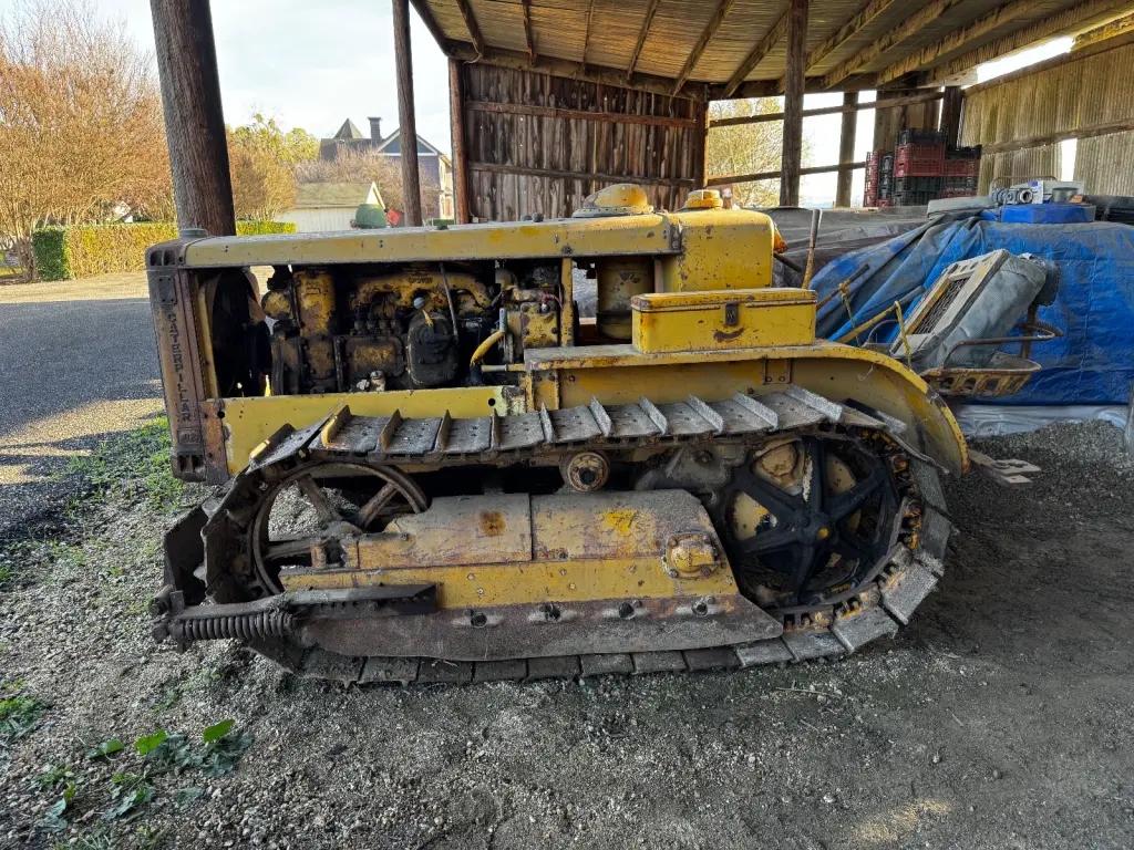

Hello! I just joined ACMOC after purchasing a 5U D2 orchard model last week and wanted to say hello and ask a couple questions. I am also a novice on caterpillar tractors so lots to learn 😊The tractor is in good shape but has been sitting in a pole barn for 5 years without running. We got her running after a while and main engine sounds great but does smoke some, guessing its oil that will burn off since it sat so long. Fuel pressure gauge doesn't work but other then a few leaks here and there its a healthy machine. My main concern is an oil leak on the left rear sprocket. The seller said he rebuild both steering clutches 5 years ago. Without tearing into it to much, how concerned should I be with the leak? You can see the leak in one of the pictures I added. Once we filled it up with oil the steering clutch and brake worked great. Should I try and get this fixed or would I be opening up a can of worms? We plan on using this tractor for cutting a fire break around our property each spring so overall it wont be used more then maybe 10-20 hours a year. Thanks!

Your question regarding the leak: many will lose some lube from sitting a long time/lack of use; I have had some thrifty folks pump some track lube (00 semi fluid grease) into the leaking side along with the gear oil, and it seems to help. Not a proper fix, but a good temporary solution that does not require a lot of $ or tear down of the tractor. The lube will solidify when cooled down and likely not ooze out like regular gear oil.

Thanks Juiceman! Yeah I definitely dont want to tear down the tractor $$ just to fix the leak if theres another solution. Thats a nifty trick with adding some thick grease and oil to help slow down the leak. My main concern is just having all that gear oil leak into the ground as the tractor shed is near a garden and our well. Just started going through the D2 this weekend, need to get her cleaned up, replace the fluids and filters and I also am thinking of rebuilding the pony motor carb.
I live in San Jose, we are on just over 5 acres in the hills north east of San Jose and love it up here. This D2 is our 3rd tractor, we also have a newer kubota 4x4 and a 1950 John Deere MC crawler that I love but its just a little under powered to pull our disc, which is why we got this D2. Ive been in love with tractors and farm equipment my whole life, my 2 year old sons first word was "tractor" haha and when ever he saw a truck or tractor he would point at it and say "dadda". Since you saw the D2 for sale are you local to the bay area? -Steven
Check and see if the oil is leaching out from splines under the big nut holding on the sprocket. Looking at your picture it appears the whole sprocket is black. If it is the bellow seal oil would be running down the case behind the sprocket.

You will need to grease your rollers anyways, so pump a little of that 00 lube mixture (not regular grease) it is semi fluid...Park it on a shallow drip pan to watch for further leaking after you run it awhile.

Side-Seat, thanks, Im pretty sure it's leaking just behind the nut on the spline. I was just looking at the parts manual for the tractor and I see theres a gasket just behind the nut, that makes me feel a bit better, hoping it's just that gasket that is leaking which should be an easy fix. Will take a look later this evening and will report back.

keep a eye on it. if its a slow leak like our d4 just keep topping it up. with some fresh oil and some use it might slow up.
we were told sometimes if the bearings need adjustment it will weep from the bellows seal and nipping the up can slow it down even fix it. to check for play jack that side up so there is no weight on the sprocket and use a pry bar lever on it to check the play. the destructions are in the servicemans book. the c hook spanner to adjust the bearing aint cheap so we just keep topping ours up.

Check the sprocket for tightness on the shaft. If the sprocket is loose on the shaft it will need to be pressed back on the shaft. You will need special tooling to press it back on if it is loose. I think it takes about 12 to15 tons of pressure.
