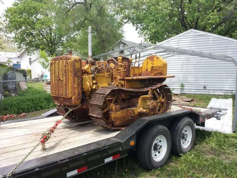

I just got home with my first Cat. Did some trading and got this D2 3j series. Story is the guy took the injection pump off due to it leaking fuel into the crank case. I plan to get the gaskets and seals to fix that then start in on the pony motor. Both the diesel and the pony are free. The pony turns over all the way but I think the valves may be stuck open not sure yet. Next step is to get it off the trailer and find some manuals for it.

Nice one - I have 3J4086. Looks like it had a toolbar - do you have that as well?

There is a home made blade that came with it but I am not ready for it yet so I didn't pick it up. This came from a very good friend of mine so I know it will be there when I am ready for it.
How hard are the top roller assemblies to find? This one is missing one.

Hello ksbowhunter,
Hope you get it running good in no time. I have 3J#4103 so they were real close on the assembly line. 1940 year of production.
