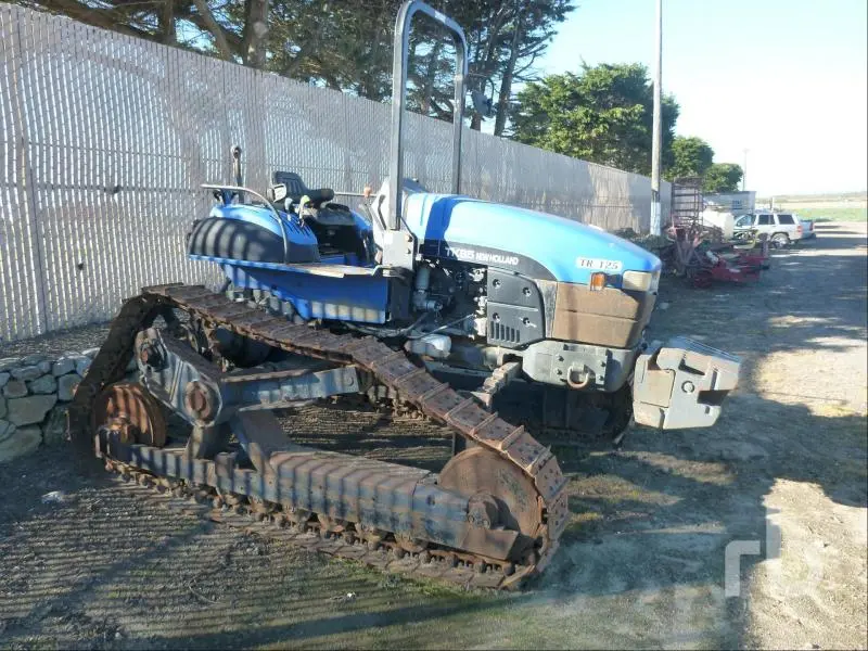

Des has nailed it again,friend replaced a IH TD6 with a New Holland(Fiat) crawler rated at 85 horse power.Puling the same disc in his dry land vineyard he was spinning and having to close the disc in the steep places just like always just spinning much faster than before.
Landini also makes a tractor in that class.What I see is New Holland ,Landini ,and Same in that order in the local vineyards. The NH seem to be the toughest of the bunch and more of them than all the others.

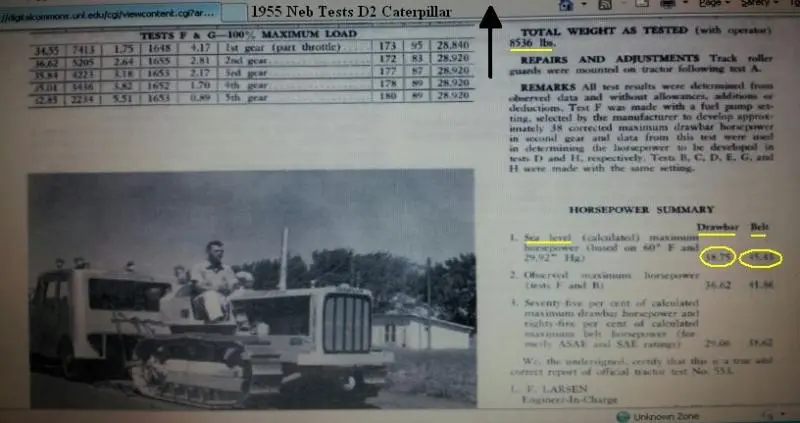

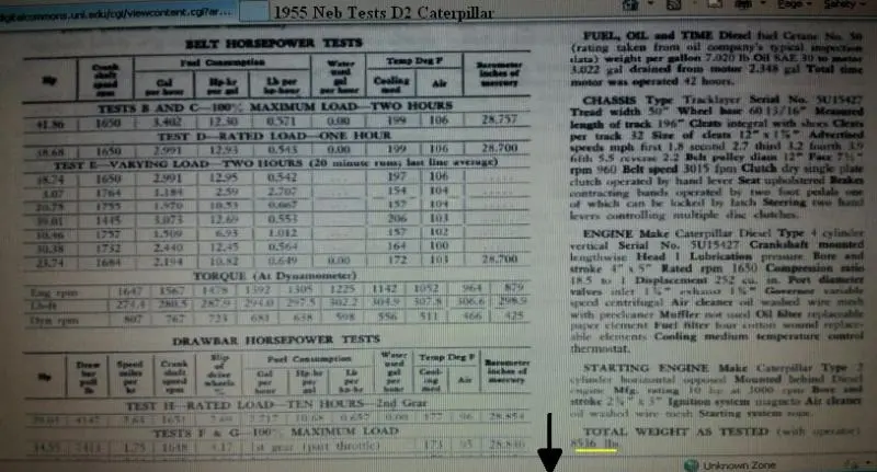

This was an interesting question to me---------with some of the comments; it made me go back up to Bruce Oz's post of the Nebraska Tests (sticky post) and look up the last test on the little D2.
The last Nebraska Test I found on the D2 was in January 1955---------sorry about the quality of my pictures (page is cut in half----stacked-----put the two arrows together)--------but this is what I found (listed under test #553---------1/1/55; the D2 was discontinued in 1957 and I didn't find a later test).
Interesting that the D2 tested (see photo) weighed in at 8536 lbs with a 180---200 lb operator. Rated at sea level @ 38.75 drawbar hp and 45.45 belt hp.
Wonder where that serial number tractor is today (#5U15427)----------anybody here claim it???
