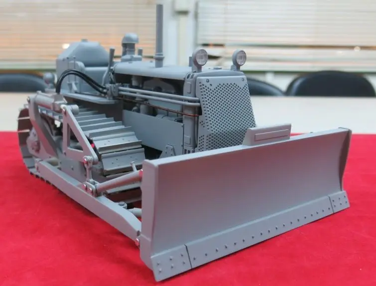

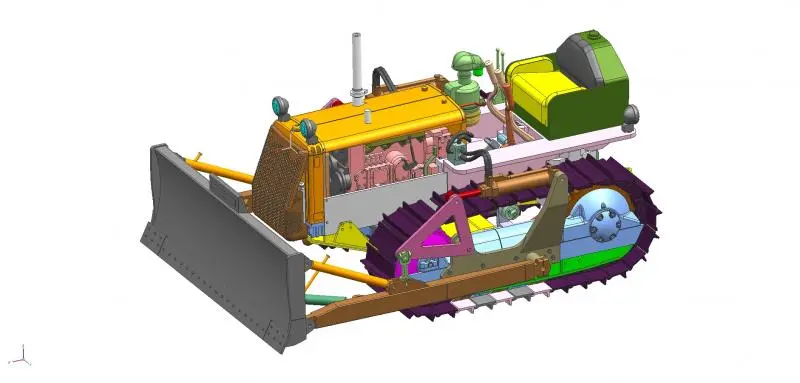

ACMOC formally announces the upcoming release of the first in a new series of scale model tractors. The D4 7U with 4 S blade and #44 hydraulic will be built in 1/16 scale. The model will be made by SpecCast Collectibles in Dyersville, Iowa. This is the first new model since the 2012 release of the Terracer and Hi-way Patrol series of implements, also in 1/16 scale. Currently, the pre-production is ongoing with CAD images and 3D modeling being presented to the ACMOC model experts for scrutiny and comments to assure accuracy. Once final modeling critiques are satisfied, final tooling and production schedules are created, and an expected delivery date can be set. These models will be a perfect compliment to the D2 series created back in 2001.

Not to be negative but just wanted to mention by observation but it looks like the lift cylinder brackets on the track frame are too far forward for a four roller track frame. ??? They are actually set forward for the five roller frame. Gary
Overall looks nice, but nice to get the details right. It looks like the clutch levers are too large, out of scale, makes it look like a Norscot cheap toy.
CCM got the blade mounts wrong when they did the D2, they are set too far back for the model they produced, they used the mounts for an earlier model. http://www.ccmodels.com/caterpillar-Cat-D2.shtml

Keep in mind that these are only rough examples that are presented for our critique. There are flaws and everything you fellows mentioned (and a lot of items you haven't) has already been observed and reported. More importantly, those issues have been corrected and we are working on the next round. This is how it is with every model, not just ours.

Looks allot better Pete. one more thing on the blade, the sides are tapered they should be straight all the way down.
Wed, Jul 1, 2015 2:09 AM
Also the tilt braces at the top were "ball and socket" not pin type. The brace was threaded at the bottom of the tube.
Gary
The same goes for the diagonal braces, they were "ball and socket" at the back of the blade and pinned at the push brace.

the tracks are on backwards, on the one with the blue carpet back ground
