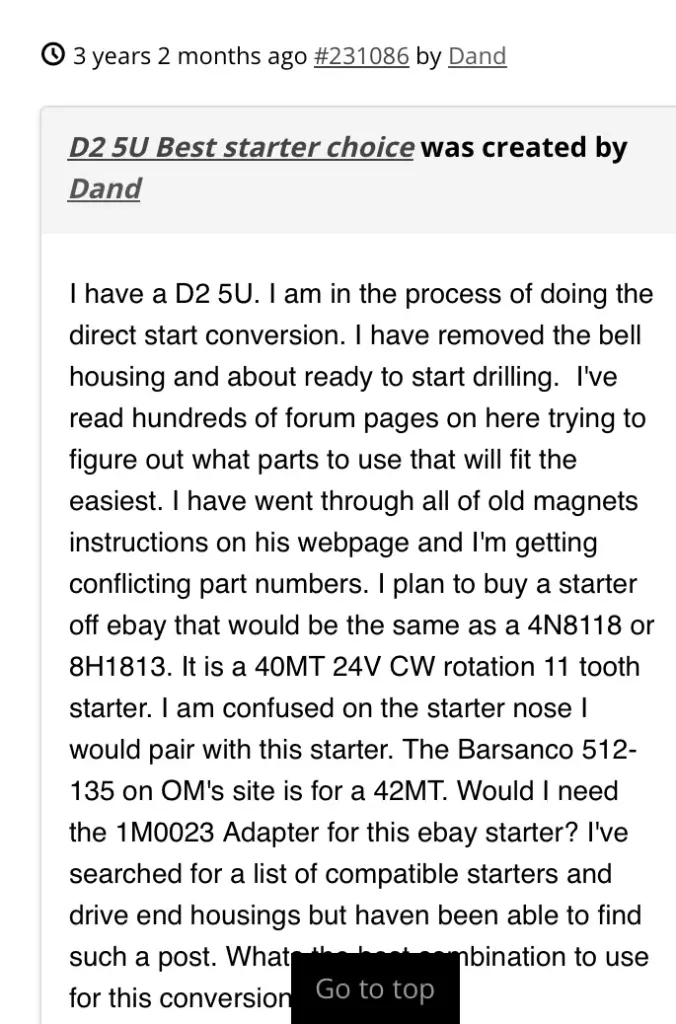

Welcome and good luck. Below is a screenshot of a d2 topic. It may or may not be exactly what you need, but it might give you an idea of how to search the site. Start with Discussion Forum and you’ll be flooded with good info. You’ll find your answers from the folks on this board-knowledgeable and willing to share.
best of luck and keep safe-

Welcome! If I were nearby, I would be glad to enlist some strong person to pull the rope for you! Just kidding of course!
If your donkey engine works, my suggestion is to find the parts to make it an electric start one, whether it be factory parts or an adaptation. TK88 is correct, some of those parts can be difficult to source, but the direct electric conversion is harder and costlier to do.(My own personal experience).
Please share some photos of your machine. You are already ahead of the game if you have 2 talented fitters (mechanics) close by to help. JM

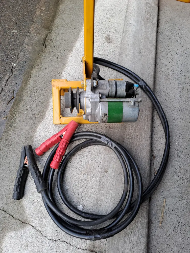

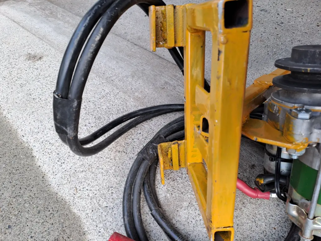

Hi have made. this works off 12volt battery will start any D2 and D4 must use B section belt
