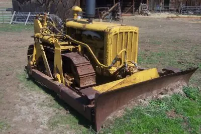

Going to have my D4 shipped so I was wondering if someone could provide me some rough dimensions and weight of my D4 6U. I am away from it and couldn't find anything local to work off of. Thanks

The weight in the parts book say the tractor is 10,505 lbs. and the length is 10ft 1/4"and the height is 5ft 9 3/8" and the width is 5ft. 2" I don,t have a blade book but it must weigh 3,000 but only guessing but someone must have the weight. There also is the hydraulic pump and jacks etc.so guessing it might be a little more than 3,000 lbs. with all it.
