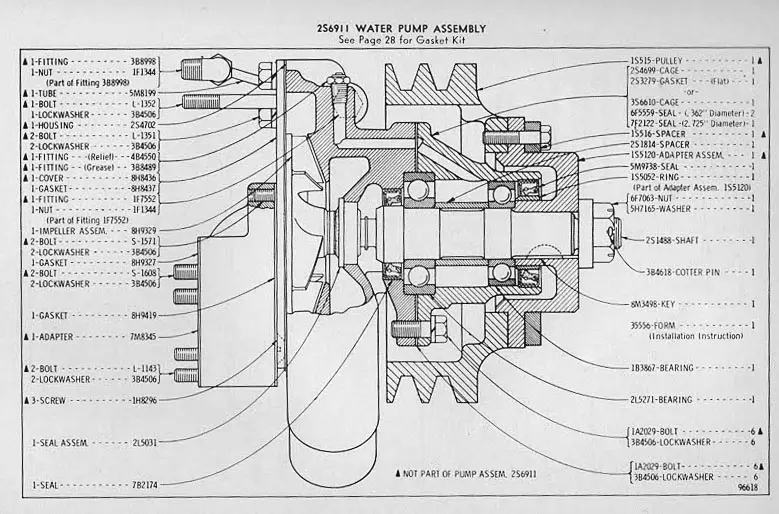

Hello everyone, thanks for letting me join. I have a 933G Traxcavator (1966 I believe) with a series number of 42A6451 and it does have a turbo. The engine has recently been rebuilt (before I bought it) but now the water pump leaks bad and the bearings are gone. I have taken to caterpillar and they cannot help me. I need a water pump (new or used) for this piece of equipment. Can someone help me? Thanks to everyone.

Complete new or used pumps can be hard to find. Why not rebuild the one you have. Parts should still be available.

Sounds like this project may be a challenge because of unavailability of a replacement for the (damaged) impeller. I am waiting to see it in person.

Friend has a hot rodded 9u D6 that has one of the Cat engines that was built in very small numbers. He needed a water pump and found a company that was into building parts and rebuilding water pumps. Not cheap but he has a working tractor again. I am sure he found them on the web,but if any are interested I can ask if knows the name any more.

Same impeller used on the D311H and D320/T
They seem to be around...
https://www.machinerytrader.com/parts/search?page=1&partnumber=8h9329&searchtype=starts-with
