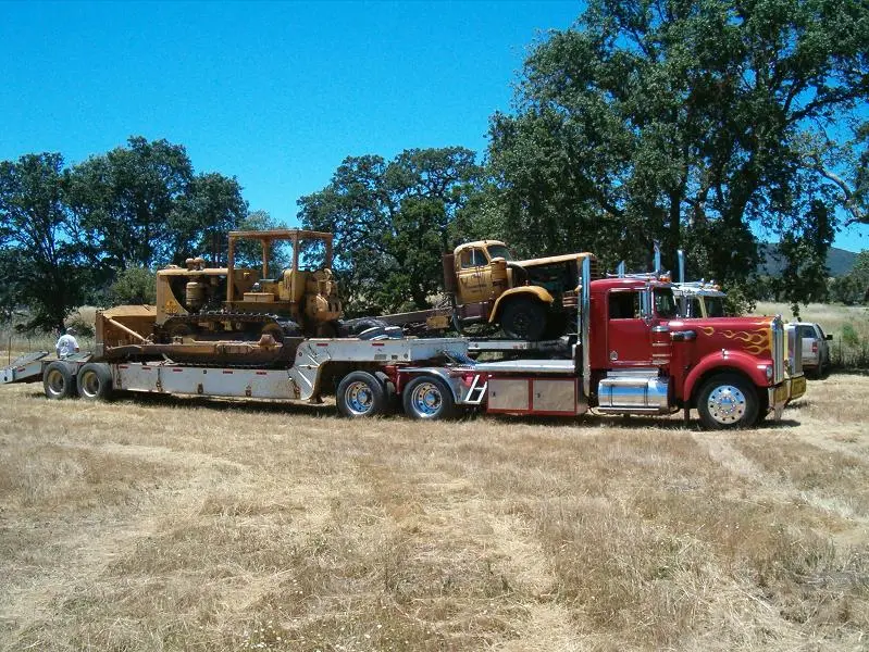

Devan, much easier to work on something at your shop than out in the field. Most likely it will take a D8 to pull the D7 out of a hole. Since I'm going to have my D8 at the Woodland show the first weekend of July you might be able to talk me into coming up there before or after the show and drag it up to your shop. Maybe we'll be able to get it fired up by pull starting it. 👍
Here is the D8 you'll be looking for, the kids are playing on it in Santa Margarita
http://www.youtube.com/watch?v=6kHHtRUVucw
If you make it to the show keep an eye out for my truck and tractor or call me
Mike
661.331.2996
