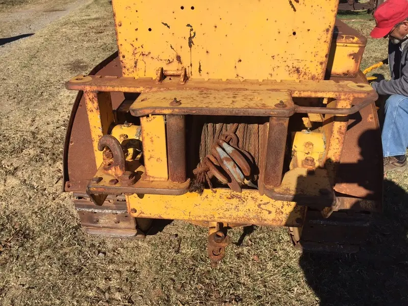

I have a very early Twenty L33. It has a Garwood winch with a shop fabricated mounting but the PTO is Csterpillar (has L with four digit part number cast in the case). What I need to know is the lubrication space for the PTO shared with the transmission space. In other words if I fill the PTO will it affect the fluid level in the transmission? I know you cant tell much from this photo but buried in there is a Caterpillar PTO that provides power to the winch. Thanks for any info.

I believe the answer is No, the trans oil is separate,
I have 2 different kinds of PTO,s for a PL 20 and could post pictures if it would help

I have a pto on my TEN and it shares the oil from the transmission. I would think the TWENTY would be similar. If it would be separate, you should be able to see the fill and drain plugs on the pto housing.
Pat

I checked the PTO yesterday and the part number cast into the case is L2044. From what I can tell the fill plug is at the same level that the plane case cover plug would be at.
