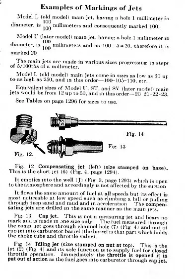

Hi Neil,
the scan below is from a carby book and covers Zenith old and new carby jet size markings.
At The Dealer we had a carby tool kit with all sorts of weird tools in and one of them I recall was like you suggested as a possible non-slip jet screw driver.
Often a gentle tap on the jet with an appropriate sized flat end punch can loosen the jet by slightly squashing down the fiber washer under the jet flange.
Hope this helps.
Tue, Dec 14, 2010 11:34 AM
