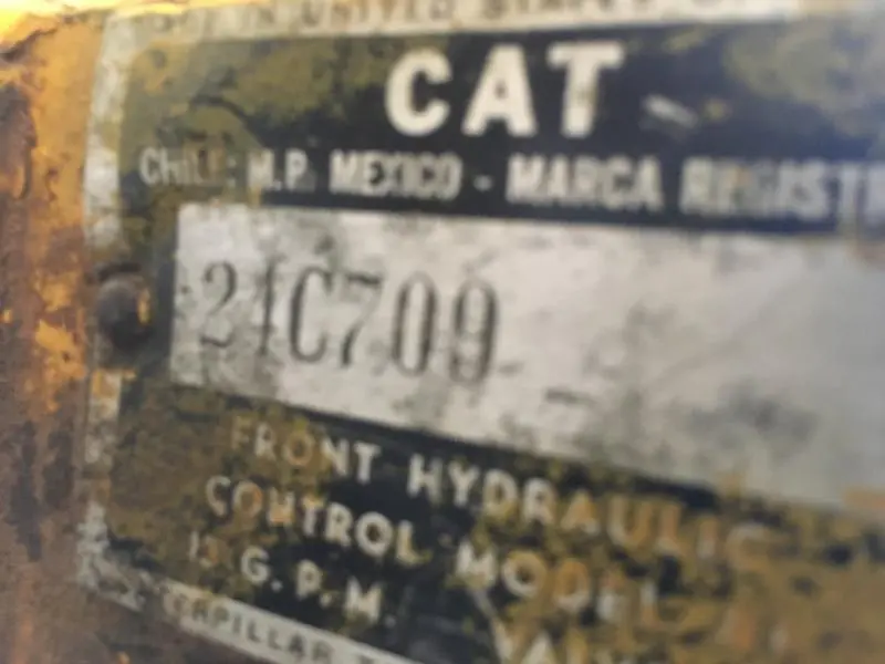

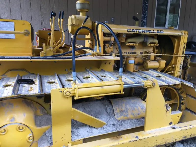

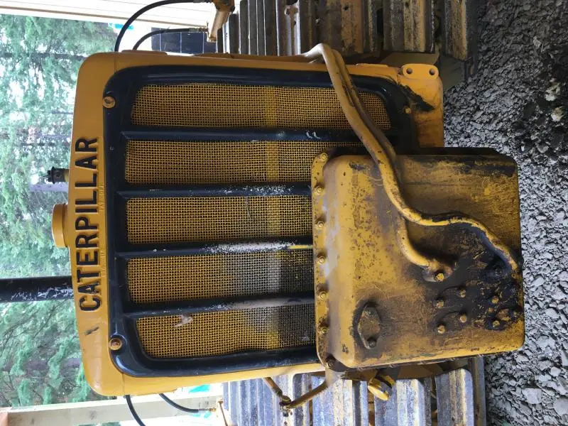

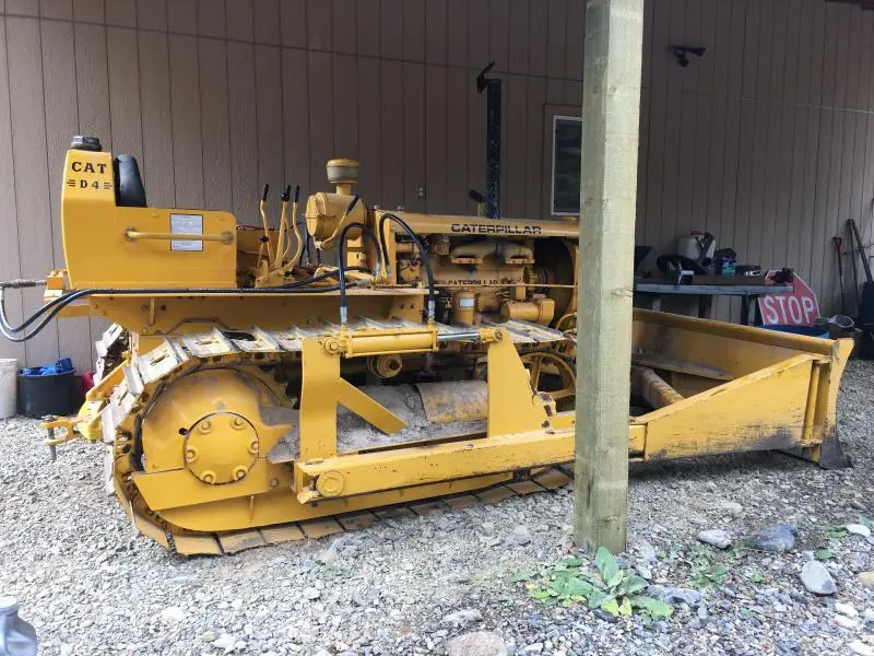

I had a hydraulic cylinder rebuilt on D4 7U.
Cat has not ran in a couple years.
I cannot get the blade to lift up now, after I replaced cylinder.
Hydraulic fluid is full.
Any help will be appreciated!
Thanks,
Ron

Have you checked the rest of the hydraulic system? Pump/valves/controls?

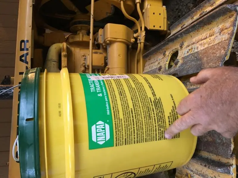

What weight oil are you using? If it's to thick nothing will happen when cold.

Try checking the hoses. Make sure they are hooked up right.

Here is a picture of the fluid I use.
Temperature outside is around 50 degrees.
Could I crack a hydraulic line and see if I can get air out of it?
