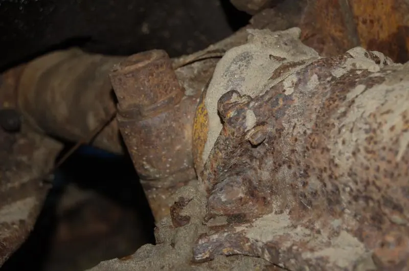

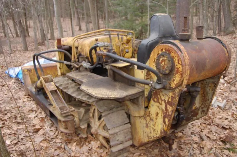

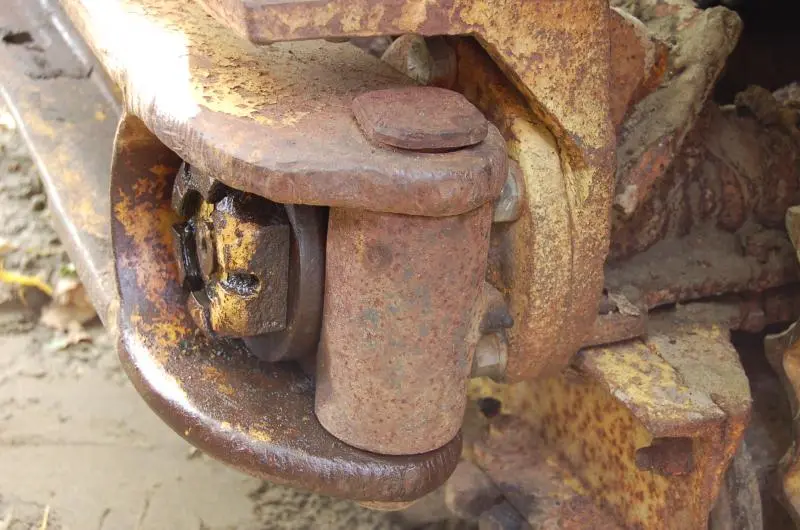

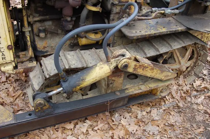

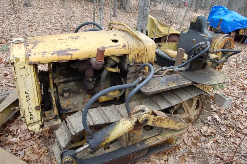

I will be removing the right final drive on my CAT22 with dozer blade in order to repair or replace the steering brake band. See attached photos. I have a few questions: 1- do you know if I can remove the final drive without removing the dozer blade assembly, if I jack up the rear of the tractor after I break the track?; 2- I assume I will have to remove the right fender in order to be able to lift out the final drive, correct?; 3- can you recommend any good sources for a replacement brake band and any other final drive parts I might need?; 4- although the right steering clutch seems to work fine, should I plan to replace it while I have the final drive out? Any suggestions are welcome. Thanks, Ray[attachment=9848]DSC_0040.jpg[/attachment][attachment=9849]DSC_0037.jpg[/attachment][attachment=9850]DSC_0042.jpg[/attachment][attachment=9851]DSC_0030.jpg[/attachment]

I would say the blade must come off, (doesn't look like too bad a job to do it) .. actually,taking the blade off will probably be the easiest part of this whole project! ..
Also I would remove the fender ( In the way , and i think fender or floorboard is bolted to some final parts)
The sprocket is recessed between the side frames and the side frames must spread apart (at the pivot) a bit to get the sprocket to come off the sprocket shaft, ( at least on a narrow machine)
While you are at it check and/or do both sides, and also check the steer clutch release ball bearing ( mine was about 2 hours from losing all the balls from the bearing) You may have an idea that maybe you can unbolt the final drive at the first flange???,, nope that don't/ wont work... you must take the whole chunk, all the way back to the trans housing. Then there is a special procedure to get the final to come off the trans housing without breaking the drum , which should be documented in previous posts , if you do a search on here...

In order to remove the blade and support frame from my 22 it looks to me like I need to pull the pivot shaft out. I don't see any other way to do it. I suspect that the pivot shaft length has been extended in order to provide the pivot for the blade support frame (see photos above). I have removed the large nuts (I call them Jesus nuts, about 4" OD) but the shaft does not budge when I try to persuade it with a 6 lb hammer and drift. In looking at the parts manual I see the bracket, part number V-266 on each side. It looks like this bracket, since it is split, is used to clamp onto the pivot shaft and keep it from moving side to side. Is that correct? If so, I will need to loosen the bolt that squeezes the bracket onto the shaft. Is there any secret I need to know about how to get to this bolt and nut? I can get onto the bolt head, but the nut is not accessible unless I raise up the tractor and crawl under it. Is that what it takes to release the shaft so I can slide it out? Also, does anyone know what the diameter of the shaft is? The end that I see when I remove the Jesus nuts outside the blade frame is about 2" in diameter. Does that sound right? Thanks for your help. Ray

I think Dave is looking at the pins at the back of the blade frame. Pull them and back out? Blades were added after the tractors were built. I'm almost sure that no one lengthened the shaft?? I haven't been under a 22 in a while but those clamping bolts should be bolted into threaded holes in the transmission case, not with nuts?. Am I correct in my memory Dave?

As I recall, they're pretty much the same as the later D2 J and U as far as the pivot shaft goes. To have lengthened it to mount the blade to would have been a major undertaking as there's a plate on both ends of the pivot shaft with a cap over it that takes the side thrust from the track frames.
There are two clamp blocks underneath as Jeff said that hold the shaft to the bottom of the tranny with either 5/8 or 3/4" (I think) bolts that go into the bottom of the tranny. Tight squeeze getting under the critter unless you're a skinny midget😆 so it's easier to run it up onto some blocks first,then jack it up a little and block up the front and rear of the critter.

I don't think you are going to be able to pull that pivot shaft out one way. If the dozer won't come off maybe whoever built it did not leave provision to remove the blade. You might have to take the gas axe to it and repair it later.

The bracket that secures the pivot shaft has two bolts that attache to the transmission housing. Then there is another bolt and nut that draws the bracket tight onto the pivot shaft, preventing it from moving side to side. This photo shows the nut and lock washer on the top of the bracket. The split in the bracket that allows to to be compressed onto the pivot shaft is clearly seen. [attachment=11169]DSC_0282.jpg[/attachment] This next photo shows the blade frame mounting to the outside bearing housing of the pivot shaft. There is a large castilated nut on the end of the shaft that allows the blade frame to pivot. I cannot tell if this shaft with the castilated nut is part of the pivot shaft (in which case the pivot shaft must have been lengthened) or if the pivot for the blade is a short shaft that extends from the flange that you can see with bolts holding it to the weldment that is on the end of the pivot shaft outside bearing housing. [attachment=11168]DSC_0281.jpg[/attachment] If the pivot for the blade frame is just a short shaft I am at a loss for how I should remove it, since there is not room to loosen the bolts that hold the outer flange to the weldment. The large vertical pin that passes through the cylinder that you can see with a grease fitting does not appear to be able to be removed due to interference with the weldment above it. It seems to be an old fashion Chinese puzzle. Not sure just how this guy comes apart. Do any of you have suggestions? Ray
