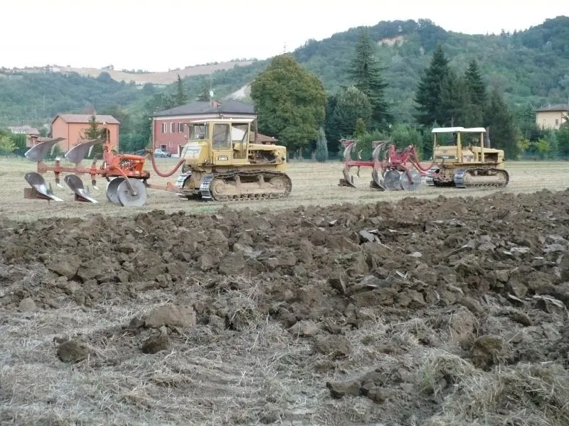

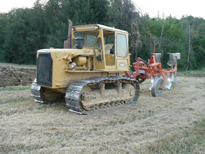

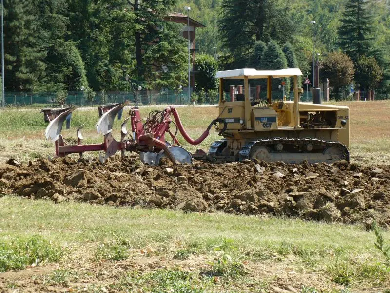

Hello, i am Robby from italy, sorry my english is not good.
I have a D6D SA (165 HP, engine 3306 PC pre-chambers unfortunately!!!!!) 6 gears Fw, 4 Rv, and D5B SA VHP (160 HP,engine 3306 DI) 6 Fw and 5 Rev.
D6 I have to purchase used from 2007 with 11000 hrs today’s 14000 and I have rebuild the motor, gear box, reducer and repainted,
D5 I have purchased new from Brazil and have 13000 hrs I rebuild to much the transmission and bevel (two times), too much power
Both to use to make plowing
The d5 is good (no good the transmission), the d6 I have make too power,3 spacer in the fuel screew, I don’t know how much is the power now,
but the problem is the warm temperature of the water engine when use in 3 th gear under stress in plowing. Have you any suggestion?

Hello Robby,Welcome to ACMOC! do you have the front idler blocks turned up for drawbar work?, it will steer alot better, and save on the back rollers.
Tue, Aug 23, 2011 8:28 AM
Oh, and nice looking tractors!!

cracking pics there Robby, how deep are you ploughing and why?......in our part of the world we can really only manage 6 > 7" (or 15 > 18cms) because of the stoney soils.

Hello and thank you all. Richard, here in my area (Bologna, Emilia Romagna) and the ground isclayey and compact. The depth is 40-45 cm. The ground remains soft and moist.
