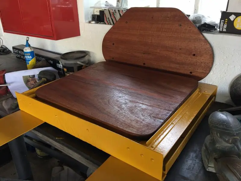

I am rebuilding the seat of my Cat 22.
I only had the old wood and the spring section for the back rest.
I made up two wooden bases and am about to take them to my tame upholsterer.
On the seat squab, there was a steel ring that obviously is screwed into the sides of the wood.
I have seen a few pics of the seat area where there are two side pieces on[attachment=42298]Cat 22 - seat - old wood and spring for backrest.jpg[/attachment] the inside of the seat.
I wondered why there was no actual arm rest on the top of these sections, to rest an arm.
Fri, May 19, 2017 1:19 PM

Good question regarding the armrests on top of the seat side rests, I bought a new seat from John Hahn for my D2 5U which is almost identical to a 22 seat and John offered that option of armrests on top which I bought and I really like them, much more comfortable than the old original style. Some people are anal about originality with their old Cat restorations and if the tractor only get's driven once a year at a old machinery show then those original features are important, but if you are like me and using your old Cats every week farming then comfort must be considered too and I like those new armrests.
Good luck with your new seat, you may want to consider cutting air vent holes in the seat base before you fit the vinyl, either that or fit eyelets in the vinyl.
regards
Mike
