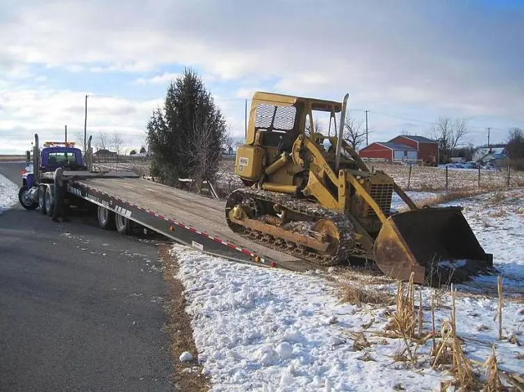

My dear bride (Mrs. G) got me two really nice Christmas presents.
1) a new pair of warm socks.
2) the item in the picture.
Serial 12A991 (what year is that? 1957??)
Currently the diesel has a fuel problem – it runs for two or three minutes and dies. It can be restarted after you re-bleed the filter housing. The Pony also has a fuel problem. It has 90% + tracks. It’s generally good condition. I bought it off of craigslist. The socks are really warm and comfortable.

My book states 12A991 as a 1955 model year, first year of production.

Not sure about your fuel problems-is the housing dry looking for seeps or maybe the intake fuel line has a poor connection or pin hole. If the pumps or injectors don't need bleeding it seems it would be somewhere on the housing can itself...

the 955c has a d315 same as the d4 .the fuel ? ,it sound like it is not pumping fuel ,runs for few min them stops ,try running it with fuel cap loose ,the breather hole maybe blocked not letting the transfer pump to pull fuel out of the tank,sounds like the transfer pump and filter are ok ? .
