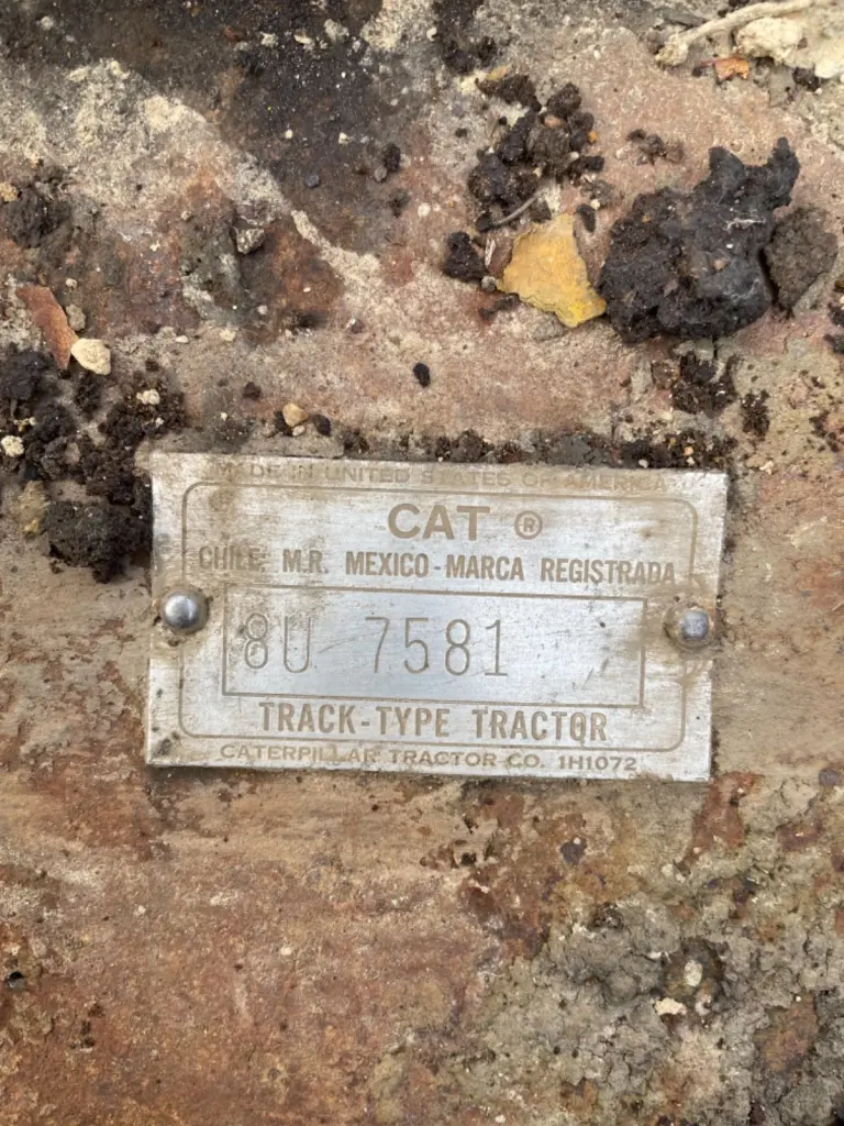

 [attachment=67273]9F470969-557E-4411-A057-E273582071D7.jpeg[/attachment]
Any info on this motor and where would be a good place too get some crank bearings ?

That came from the factory with a Cat D318. Been to long since I overhauled one to say today about who has what parts. The last set of pistons and sleeves I used was TRW, but think the bearing where from elsewhere.

Looks in the parts catalog in the Library for the manual that covers your serial # range, then search on machinerytrader.com for the part numbers you find. You can also ask the Cat dealer as they sometimes have the older stock

Cat should have the pistons and liners, American Crane and Tractor has CGR parts also, good quality.
